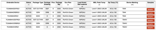

Whether TCAN844V-Q1 support receive-only mode like TLE9251VLE?
Has TCAN844V-Q1 RTMed already? I know TCAN844-Q1 has RTMed.

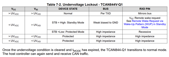

Hi Beida,
The device do not feature a dedicated receive-only mode. However, it offers standby mode which maintains the receiver active while disabling the transmitter. This effectively allows the device to monitor bus traffic without transmitting similar to the TLE device. The device is also available to order, thanks.
Michael.
