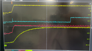

I wonder why does it need 1.5K and 1uF for reset circuit in the EVM Board?
It makes almost 30ms delay on reset signal.

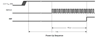

According to the Datasheet, the /Resest pin needs to be pulled up only after 1ms.
In our system, sometimes USB doesn't work at all.
We have 1.5K and 1uF for reset, and our power up sequence is like this.
 - Yellow : 3.3 VCC
 - Blue : DP0 (pin 1)
 - Red : XTAL1 (pin 30)
 - Green : /RESET (pin 4)
 * Horizental : 20ms/div
