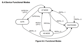

Does sn75dphy440ss has register indicate function mode status?
    The DPHY440 does not have register that can indicate the different function mode status. Is there a specific issue you are facing?

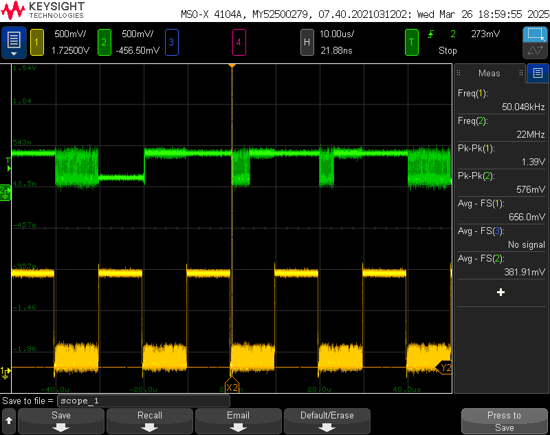

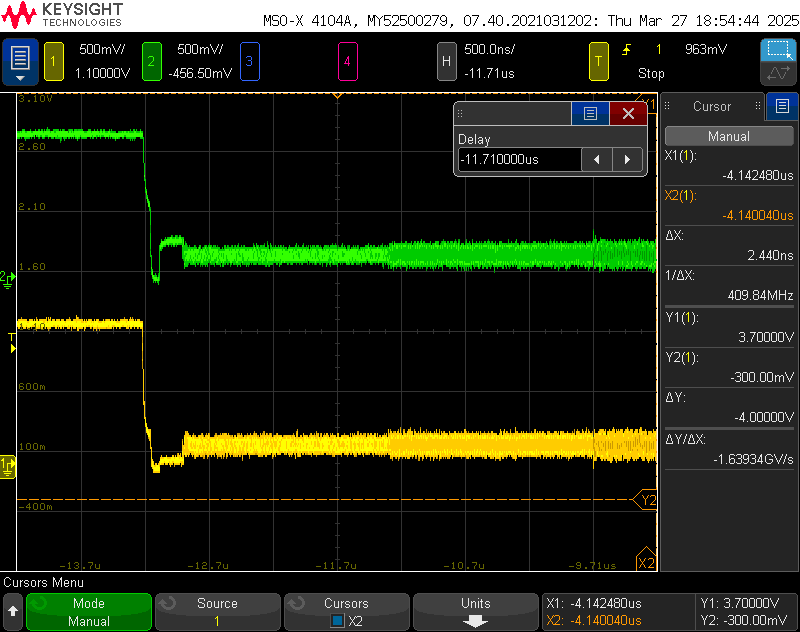

    We meet some problem
    Host can't recognize MIPI signal from DPHY440
    if remove DPHY440 bypass signal ,function is OK

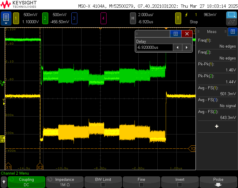

    Following are waveform
    yellow means DPHY440 input(side A)
    green means DPHY440 output(side B)
    A.pin 10,MIPI CLK
    B.Date lane

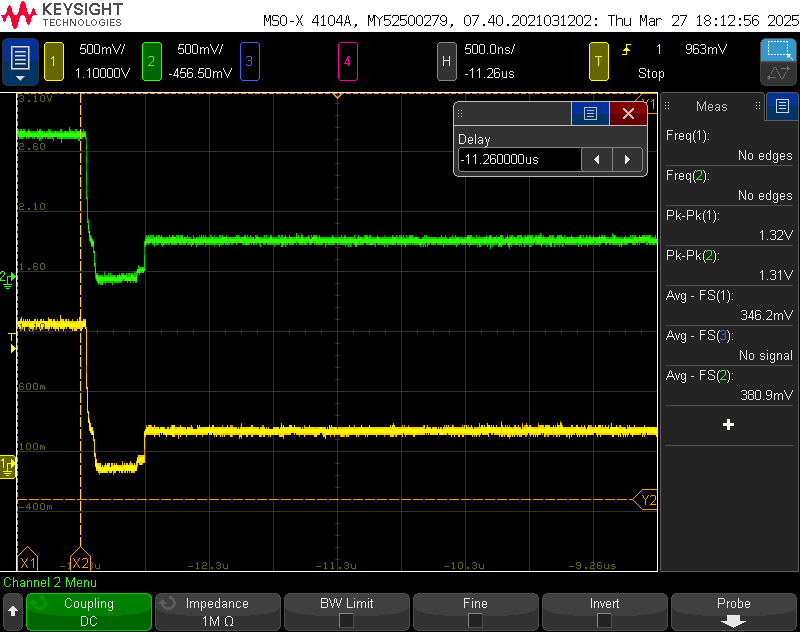

    Are you seeing the issue on both the data and the clock lane?
    Looking at the clock waveform, I don’t see the LP state.
    For both the data and clock, can you zoom into the waveform and verify there is a sequence of LP11-LP01-LP00 before transitioning to HS mode?
    David

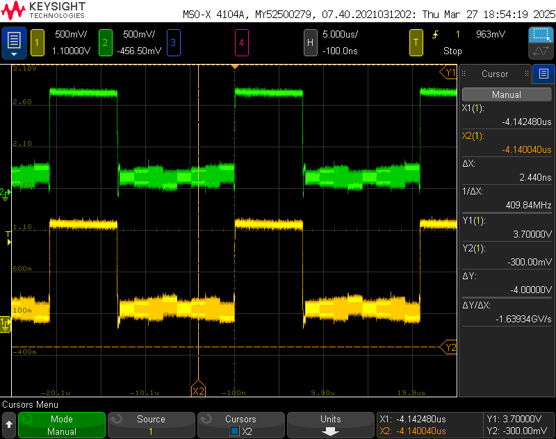

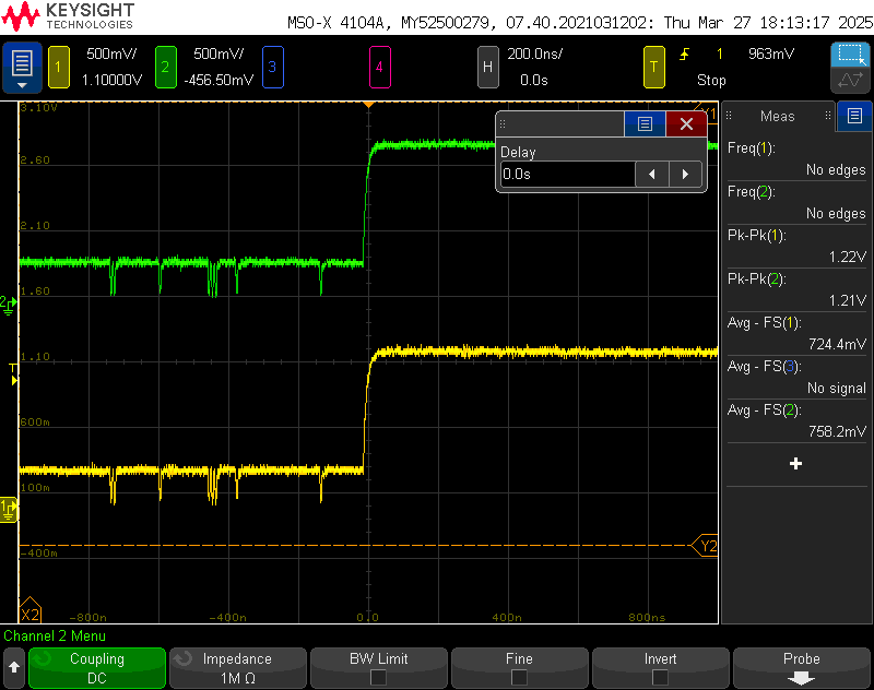

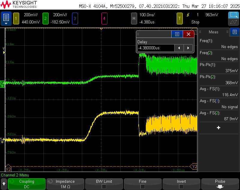

  • Hi David

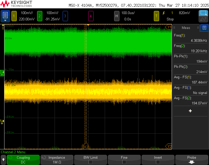

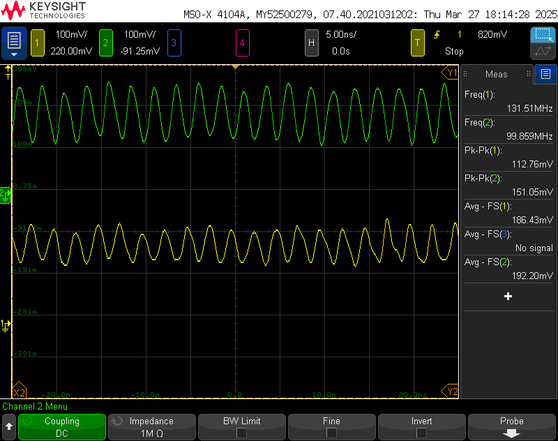

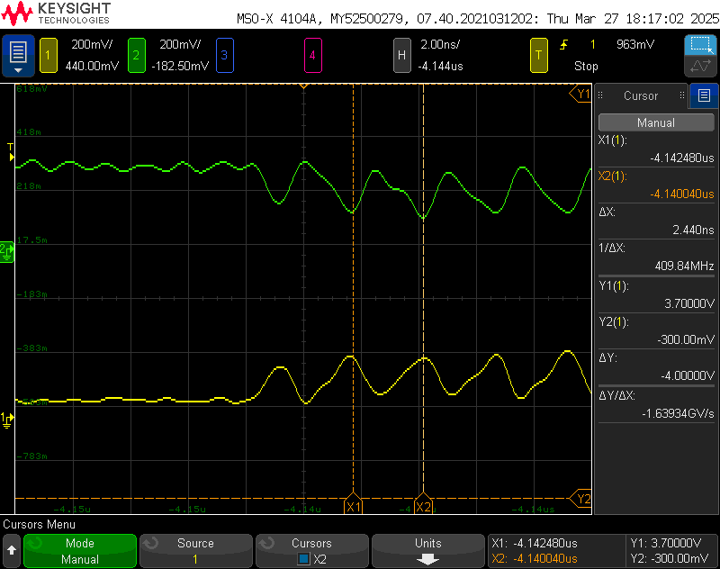

    Here are waveform , MIPI source is DS90UB954 test pattern
    CLK signal don't have LP mode, only 400MHz CLK
    channel 0,1 and 3 seem NO HS data output at side B
    channel 0,1 waveform are similar
    channel C and 2 output looks fine
    I will show 3 kind of waveform
    A. Channel 0,1
    B. Channel 3
    C. Channel C & 2
    yellow : Positive signal
    green : Negative signal

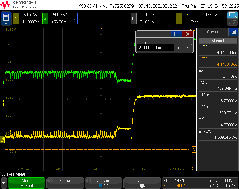

  • Channel 0&1 Side A
    Channel 0&1 Side B (seems NO video out)

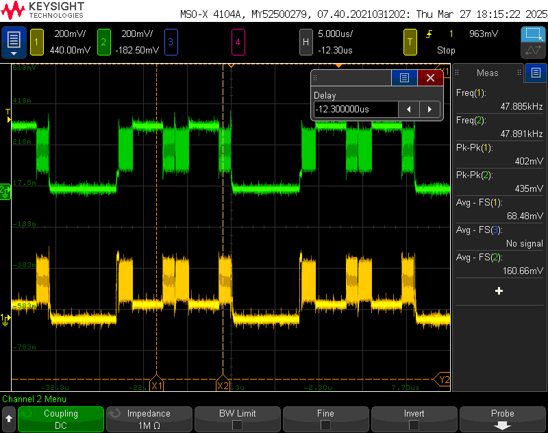

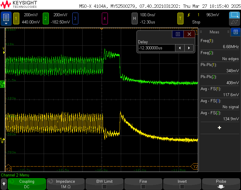

  • Channel 3 ,side A (this channel is 954's CLK signal)
    Channel 3 ,side B

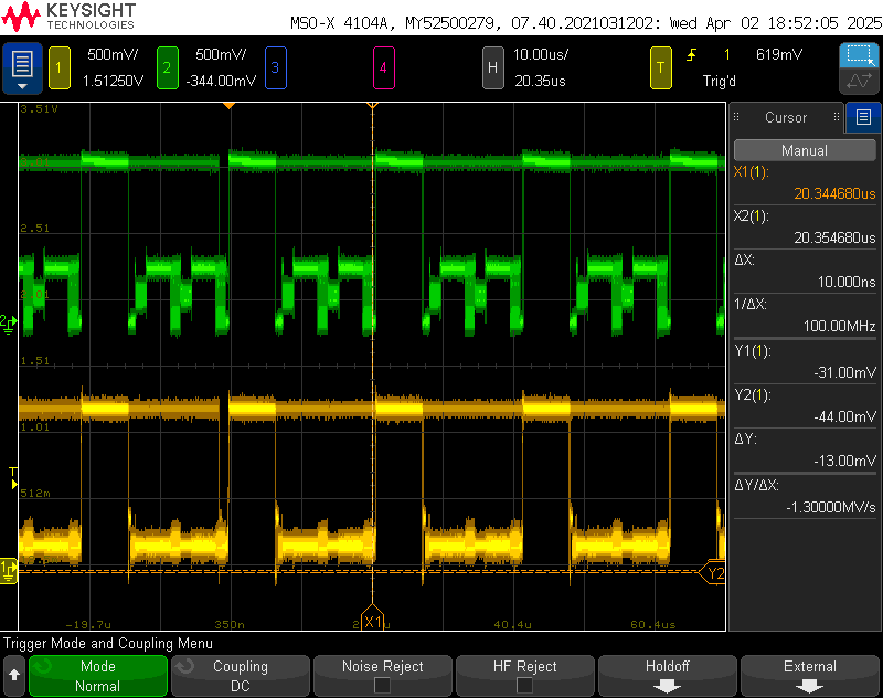

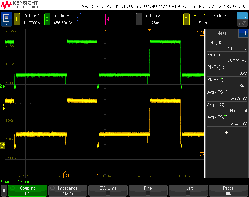

  • Channel C & 2 ,side A
    Side B

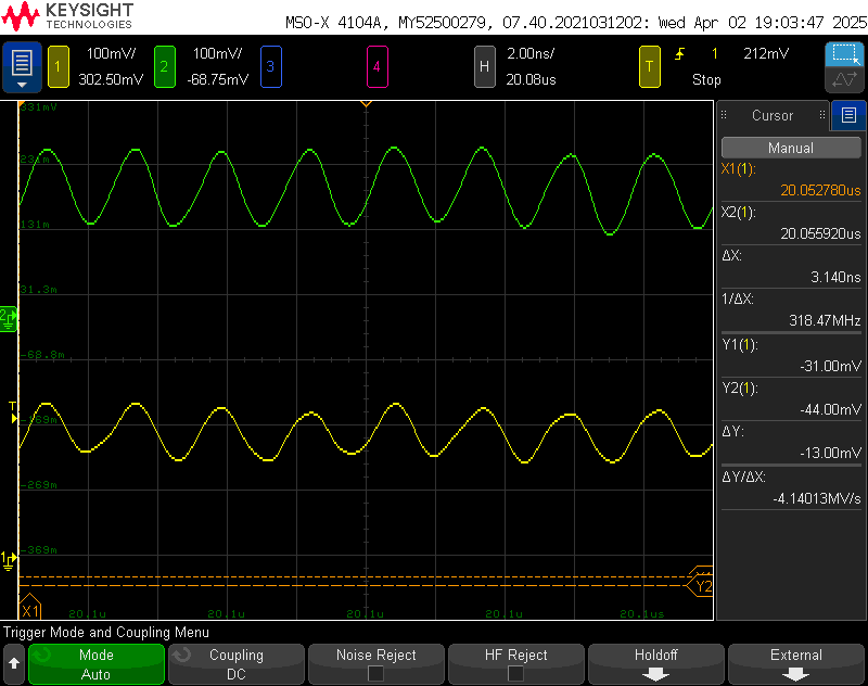

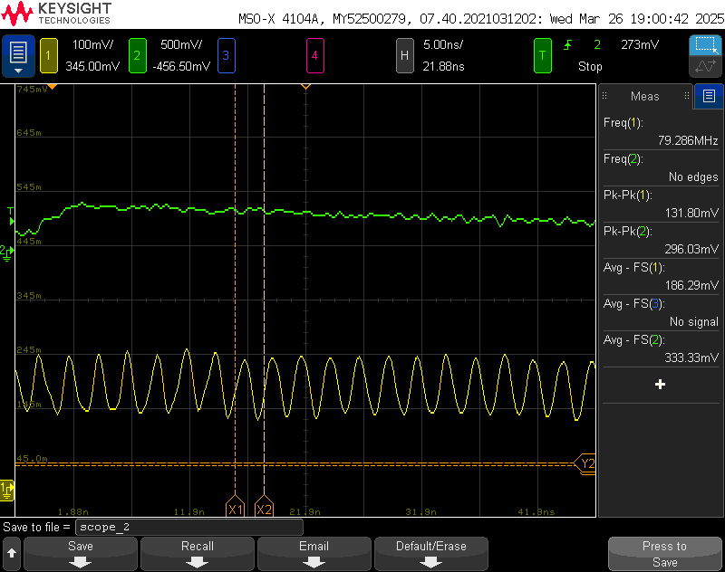

  • Hi Zoe
    set 0x33=0x01
    waveform :CLKN
    yellow :input / green :output
  • Hi Zoe

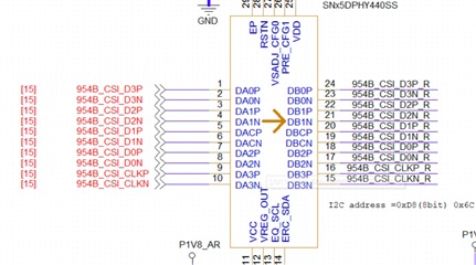

    I try another way ,change the input port of CLK of DPHY440SS
    954's CLK to 440SS's pin  5&6
    CLK sine wave successfully output to DPHY440SS side B
    I guess maybe that was wrong at beginning
    CLK signal should connect to 440SS's pin 5&6 not pin 9&10
    (I change pin ordering because of layout reason)
    so I have a question
    Does UB954 to 440SS (4 data + 1 CLK lanes) should follow the default pin of 440SS?
    or doesn't, just only CLK  need?
    Can 440SS auto detect the data lane order then adjust ?
    in UB954 datasheet P.24 ,data lane looks be in order
    With DPHY440 being a MIPI re-timer, you have to connect the 954's CLK output to the DPHY440SS clock input. But the data lanes can be swapped as long as the lane order is matching between the input and the output of the DPHY440.
    Please also note that unlike DSI, CSI-2 does not have a back channel path. But when using DPHY440 in a MIPI CSI-2 design, special attention must be paid to lane 0. With Lane 0 path (DA0P/N and DB0P/N) supporting bi-directional LP signaling, it is very important that DB0P/N LP TX is connected to an unterminated LP RX.  If DB0P/N LP TX is connected to a HS RX, then LP signaling will not be able to reach the LP11 levels and which will cause the DPHY440 to not enable HS data path on Lane0.

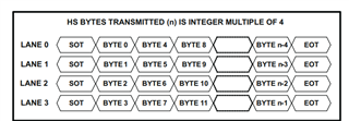

    In order to support DSI, DPHY440 lane 0 is different from all the other lanes as shown below.
    So you can see lane 0 has LP TX and RX at both input and output. Since it has both LP TX and RX, the DPHY440 lane 0 output expect to see an unterminated TX. Otherwise the DPHY440 will not able to transition from LP to HS mode.
