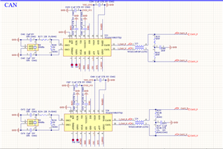

    1、 The "CAN0" mentioned above corresponds to the "CAN1" interface in the schematic diagram, and the terminal resistor on "CAN1" is connected to another distant transceiver position, as shown below:
    2、When our device fails to send, it can receive data normally, which should have nothing to do with the crystal oscillator and power supply of the TCAN4550 chip, otherwise it can not receive data normally
  • Hello wulu,
    Thanks for the schematic information.  I will point out that the series 22 ohm resistor is generally located on the OSC1 pin instead of the OSC2 pin because the OSC1 pin is the output of the transconductance amplifier sourcing current to the crystal. However, I don't think this is causing your error.
    Please see the TCAN455x Clock Optimization and Design Guidelines Application Report (Link) for more information.
    When you have a large number of transmitted errors, this is often associated with incompatible bit timing configurations between the different CAN nodes trying to communicate on the bus.  Can you verify the exact bit timing configuration for all of the other bus nodes and make sure they exactly match the bit configuration you are using for the TCAN4550-Q1?
    Also, can you capture the CAN messages on a scope so that we can see if there are any issues with the physical CANH and CANL signals that explain why the messages are generating errors?
    I noticed that you have a 0.1uF (100nF) capacitor between the two 60.4 ohm termination resistors.  This may be too large, and a common value is 4.7nF or 0.047uF.  It's possible the larger capacitance is filtering out some of the signal and preventing the bits from reaching the full recessive level resulting in bit sampling errors.
    Is there only the one set of termination resistors on your CAN bus, or are there two sets of termination resistors?
    Jonathan

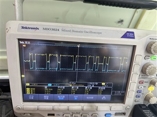

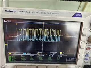

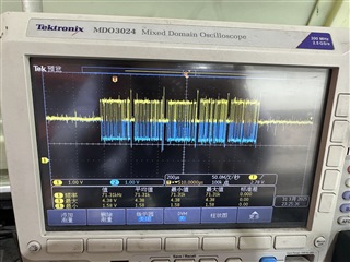

  • Hello Jonathan Nerger,
    1、Now the CAN bus waveform in the case of positive difference communication is measured, but it cannot be measured temporarily in the case of abnormal communication.
    There are a total of nine devices on the bus, and only my device CAN0 has the following waveform when sending data:
    When the following eight loads are also powered on, some devices also start to communicate when the waveform is as follows:

    When there is a problem, the 120Ω resistance directly used at the beginning is as follows, without the 60.4Ω resistance and 100nF capacitor, and the state you see in the above figure is changed later, so the abnormal state that the equipment can only receive and cannot send will occur about 2 hours after use in both ways.
    3、Is there only the one set of termination resistors on your CAN bus, or are there two sets of termination resistors?
    Yes, there is a terminal resistor on the other end of my bus, and the usage of my two TCAN4550 devices is as follows:
  • Hello wulu,
    Why are they only using half of CAN bus termination called for in the CAN standard?  There should be two sets of 120 ohm termination which create a total resistive load of 60 ohms (typical).  These termination resistors also function to absorb and dampen reflected energy on the bus and improve signal integrity.
    The transmitted errors they are receiving may be due to the improperly loaded and terminated CAN bus.
    Can they add the second set of termination resistors to the bus and see if this resolves the transmission errors?
    Jonathan
    There is also a 120Ω resistor on the board of Device 1, as you can see in the schematic diagram
  • I'm sorry, I misunderstood the termination locations.  I stand corrected.
    The scope plots still show that the dominant and recessive voltage levels should be sufficient to to sample the bits correctly. With limited information on the register log file, and no scope plots of the transmitted frames that generated the errors, I'm not sure what is causing the errors.
    Looking back at the previous information, I see the sample point for the bits is set to 87.5%.  I believe the Linux driver calculates and assigns the number of time quanta (or high speed clock cycles) to be used to create a bit period that matches the desired rate.  It also calculates the sample point by assigning the number of time quanta to be used before and after the sample point.  Sampling the bit near the end of the bit may not work for all applications and you may get better results by adjusting the sample location a bit earlier.  You might try to move the sample point and see if there are any improvements.  This can be done by adjusting the ratio of the time quanta allocated in the NTSEG1 and NTSEG2 fields of the Nominal Bit Timing and Prescaler Register (0x101C).

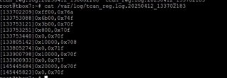

  • I read the 0x1040 and 0x1044 registers every 100 ms and log when a change occurs, and get this
    The format is [hours, minutes, seconds, milliseconds] (0x1040,0x0144 register value after change)
    The problem occurred at about 14:51:43 p.m.
    Scenario: Device A sends a heartbeat packet to device B on the CAN bus via tcan4550. The process continues until device B discovers that it has lost the heartbeat packet from device A. At this point, we find that device A can still receive data packets from the bus normally via tcan4550, but it cannot send a successful data packet.
    Monitoring more registers at too high a frequency will affect the normal interaction process of tcan4550, so other registers are not monitored for the time being.
  • You can find the bit descriptions for these two registers in the datasheet and the CAN Error Logging Counter (CEL), Receive Error Counter (REC) , Transmit Error Counter (TEC), the Data Phase Last Error Code (DLEC) and Last error Code (LEC) are defined and update according to the ISO 11898 CAN Standard protocol.
    [133702209] CEL = 0, REC = 255, TEC = 0, BO = 0, EW = 1, EP = 1, DLEC = No Change from previous read, LEC = Form Error
    [133753088] CEL = 0, REC = 107, TEC = 0, BO = 0, EW = 1, EP = 0, DLEC = No Change from previous read, LEC = No Change from previous read
    [133753121] CEL = 0, REC = 59, TEC = 0, BO = 0, EW = 0, EP = 0, DLEC = No Change from previous read, LEC = No Change from previous read
    [133753251] CEL = 0, REC = 8, TEC = 0, BO = 0, EW = 0, EP = 0, DLEC = No Change from previous read, LEC = No Change from previous read
    [133753440] CEL = 0, REC = 0, TEC = 0, BO = 0, EW = 0, EP = 0, DLEC = No Change from previous read, LEC = No Change from previous read
    [133805142] CEL = 1, REC = 0, TEC = 0, BO = 0, EW = 0, EP = 0, DLEC = No Change from previous read, LEC = No Error
    [133805274] CEL = 0, REC = 0, TEC = 0, BO = 0, EW = 0, EP = 0, DLEC = No Change from previous read, LEC = No Change from previous read
    [133900798] CEL = 1, REC = 0, TEC = 0, BO = 0, EW = 0, EP = 0, DLEC = No Change from previous read, LEC = No Change from previous read
    [133900933] CEL = 0, REC = 0, TEC = 0, BO = 0, EW = 0, EP = 0, DLEC = No Change from previous read, LEC = No Change from previous read
    [145445684] CEL = 2, REC = 0, TEC = 0, BO = 0, EW = 0, EP = 0, DLEC = No Change from previous read, LEC = No Change from previous read
    [145445823] CEL = 0, REC = 0, TEC = 0, BO = 0, EW = 0, EP = 0, DLEC = No Change from previous read, LEC = No Change from previous read
    What I can see from this log is that there is initially a lot of Receive Errors based on the REC value.  Occasionally the CEL is incremented.  But nothing shows transmit errors or a reason why the you are not able to transmit a message in this log.
    The previous register value file shows there is a single TX Buffer Element allocated for the TX FIFO.  You may want to monitor the TX FIFO Status, Request Pending, and Transmission Occurred registers to confirm whether messages are loaded into the FIFO and transmitted properly.  If the message fails to send for some reason, then your driver may not be able to load a new message into the only TX buffer you have allocated resulting your observation that you are not able to transmit messages.
    Try to monitor registers 0x10C4, 0x10CC, 0x10D8.
    You could also try increasing the size of the TX FIFO to contain more than 1 TX Buffer elements.

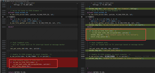

  • Hello, the data log didn't show a reason why the TCAN4550 would not be able to transmit.  The error counter registers don't show errors, and the config and control registers show it to be in normal mode with the MCAN Initialized and able to communicate on the CAN bus.
    I noticed that the TX FIFO/Queue Status register 0x10C4 would either show the TX FIFO as having 1 free TX buffer element, or it was Full.  The last time it showed it full in the log was timestamp [104214317].  Shortly after this the TX Event FIFO shows it had a new event element at timestamp [104215224].  After this, there are no more TX Event FIFO interrupt bits set in the MCAN Interrupt register, and the TX FIFO Free Level always shows 1, meaning the TX FIFO doesn't have a message to transmit.
    It appears the reason the TCAN4550 has stopped transmitting CAN messages is because the processor is not loading any messages into the TX FIFO because the TX FIFO is always empty and the TX Buffer Add Request Pending register 0x10CC is always showing no messages have been added for transmission.
    Please verify the processor is correctly loading messages into the TX FIFO Buffer Elements and setting the TX Buffer Add Request Buffer Number in the TXBAR register 0x10D0.
    Jonathan
  • After repeated verification, we confirmed the problem: there is a vulnerability in the sending logic of the kernel driver.
    Since there is only one sending fifo, in the sending thread, the sending register M_CAN_TXBAR is enabled first, and then the sending fifo is determined to be full. If the fifo is full, the can software queue is closed. After judging that the fifo is full, an interrupt may interrupt this process, causing the logic judgment to fail.
