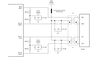

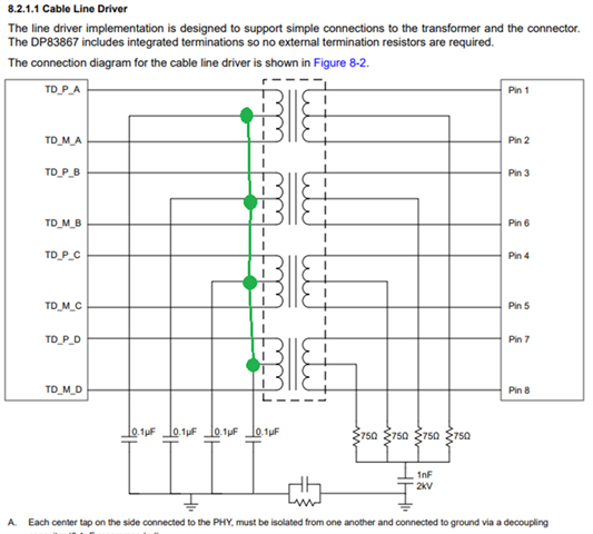

Referring to the datasheet link below at page-105, Figure 8-2 show that the center tap of transformer had independent connection closed to PHY side. But we found some other solutions wired all center taps together. Our questions are as followers
  1. Any difference of these two structures?
  2. Which one is better and TI proposed?
DP83867E/IS/CS Robust, High Immunity, Small Form Factor 10/100/1000 Ethernet Physical Layer Transceiver datasheet (Rev. F)
