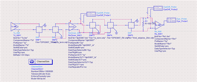

My customer is asking about IBIS-AMI Model in DP83867IS.

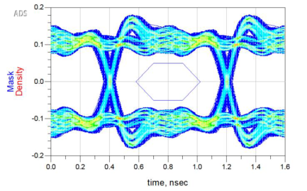

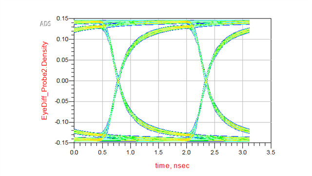

They confirmed eye mask for Receive signals with IBIS Model(SNLM211.ZIP).,
but the waveform is greatly distorted.(below)
They referred below E2E and think that there may be a problem with the BIS model.
Probably I think they use ADS as tool from their captured signal wave(above).
(+) DP83867E: DP83867ERGZR PHY SGMII EYE MASK REQUIREMENT - Interface forum - Interface - TI E2E support forums
Could you please give some advice or comment for IBIS Model?
