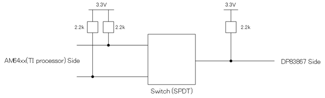

According to their investigation, they found that they used a little bit strong pull up resistor for MDIO line.
According to datasheet, you recommend to use 1.5kohm for MDIO line. But they used 1.1kohm(In fact, customer configured as shown below.) in this line.
So, they removed 2.2k PU resistor at DP83867 side, then it looks that this issue is fixed.

  • Hi Machida-san,
    How often does customer observe the issue with 2.2k PU?
    200mV is sufficiently below low threshold for the PHY (VIL = 0.7V for 3.3VDDIO), but I'm not clear on VIL/VIH thresholds on MAC side.
    When capturing MDIO waveform, does it meet VIL/VIH thresholds for both MAC and PHY spec? Are PHY/MAC both using same VDDIO domain?

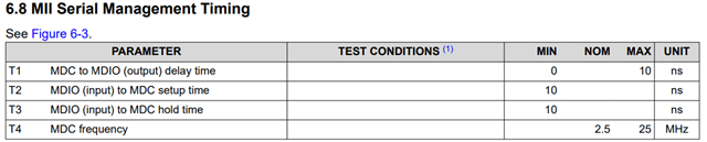

    I would also like to confirm any possibility of setup/hold time violation with 2.2k PU:

    After investigating customer side, customer observed MDIO read issue in case of PU resistor value 2.2kohm as well.
    When they changed this PU resister value to weaker value than 2.2kohm (they tried to use 3.3k, 4.7k, 10k and no PU resistor.), they said that they do not observe MDIO read issue.

    At first, they did issue with 1.1k PU (composite resistance of 2.2k). In this case, I heard that failure rate was less than 1%.
    MAC side is AM64xx TI sitara processor. And we believe that VIL/VIH is satisfied on MAC side as well.
    Attached information include setup/hold time for "command" and "Read" data.
    It seems that setup/hold time of "PHY" side is satisfied datasheet specification, however I think that I need to check detail about MAC side because it seems that setup time is NOT satisfied.

    Then, I have one additional question.
    Q. As I said above, customer will change PU resistor for MDIO line to weaker value than datasheet description.
    What do you think about this change ?
    (In the first place, It seems that MDIO line is push pull architecture, so I think that PU resistor is not mandatory.)

  • Hi Machida-san,
    Thank you for confirming and sharing the data.
    The setup and hold time for #1/#2 waveforms are compliant with PHY timing.
    Please let me know if timing on MAC-side is compliant.
    PU is mandatory to maintain default high state. Using a larger resistor value is acceptable, as long as VIL/VIH thresholds, and timing requirements are met. If customer sees no issue over many iterations with >3.3k PU, then this is acceptable.
