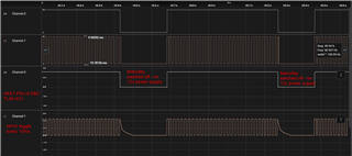

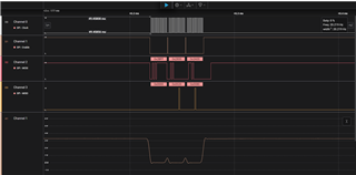

I am facing issue while configuring Window watchdog as below,
CASE 1: When I flash software using IAR workbench with Seggar J-Link debugger, software seems running fine. please refer screenshot below.
CASE 2: If i perform Power OFF --> Power ON with 12v Powersupply, MCU sends valid SPI command however MISO line stays always HIGH. After ~170ms MCU gets reset and same sequence repeats. Please refer screenshot below,

  • Hi Halappa,
    I would recommend to add print statements or debugging outputs to help verify which states are being entered during execution I.e., tracing if the watchdog service case is reached. See below hints, thanks.
    • Not ensuring that the watchdog timeout is correctly set per the timing of servicing aligning with your application's loop frequency.
    • Not ensuring the SPI is set up correctly before sending commands I.e., clock polarity, phase, etc. are consistent.
    • Not ensuring that the device goes through a proper initialization sequence after a power cycle, if any dependencies that may mot be initialized correctly after power on.
    • If feasible, verify and test with a minimal version of your code that only initializes the watchdog and SPI so as to help isolate the issue

  • Thanks Michael for quick response.
    Regarding Watchdog servicing , i have used e.g.configuration provided in datasheet,
    This is verified in CASE1 mentioned in above my query (where reset does not occure). I see watchdog is serivced every 49.45ms frequency.
    However I have doubt on first watchdog trigger made, as per my code it happens after MCU startup at ~15ms, 65ms,115ms,165ms, 215ms......so on. So first trigger at ~15ms is valid or I need to take care of some requirement ?

  • Hi Halappa,
    Yes, if you are using the window, the watchdog expects servicing within a valid window and triggering too early can count as a violation causing a reset.
    I would recommend to wait after 25 ms before servicing the first time I.e., you may delay your first window to about 30 ms or later by adding a safety delay after MCU reset, thanks.
