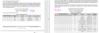

The main difference between TCA and TCAL is the voltage range changes, data rate, and agile I/O registers.
TCA vs. TCAL
1.65V to 5.5V --> 1.08V to 3.6V
400kHz --> 1 MHz
register map differences:
Tyler
Are there any issues when using the TCAL9538 with a Linux driver?
Since the TCAL9538 has many more registers compared to the TCA9538,
could that cause compatibility problems?
Alternatively, could you recommend an IC with similar specifications to the TCAL9538 that has a well-supported Linux driver?
The TCAL registers are backwards compatible with the TCA registers, so the driver will work, but only for the common features.
If you do not need the additional features of the TCAL, just use the TCA. Otherwise, you have to extend that driver, or write your own.
