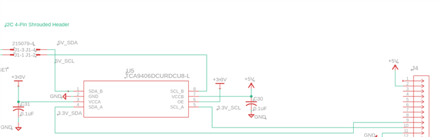

We are using the TCA9406 to translate from 3.3V to 5V, and are seeing seemingly random failures where either the SDA or SCL lines (on either the A or B side) measure out a low resistance (50 to 140 Ohm) with respect to ground. This makes any attached devices lose control of the bus, since the signals are held to a low voltage of ~0.8V.
The master side is an offboard FPGA connected to another TCA9406 for 1.8V to 3.3V translation, and the 5V side is an offboard microcontroller. We are utilizing the internal pullups on the 2 chained TCA ICs on the 3.3V side, and the 5V side has internal pullups on the MCU of ~20kOhm.
These devices are not being hot-plugged, but they do get power cycled arbitrarily. They generally work well, functioning during initial bootup and installation, but seemingly spontaneously fail, possibly after being power cycled, or possibly mid-operation. It should be noted that we have tied the OE to VCCA, so the device is not being disabled during power cycling.
Obviously there is some damage to the device, but it is not clear how such a thing would happen. The power supplies are generally fairly well regulated, and it seems strange that the device would fail spontaneously. My best guess is somehow some ESD damage that weakened the device, coupled with some transient surge that finally did it in? I have captured the boot-up and down sequences, though, and they are nice and clean ~2ms ramp ups.
We are considering just changing parts and communication scheme (UART), but any guidance on possible short-term suggestions for alleviating these failures would be greatly appreciated.

  • It gets stuck not quite at LOW, just some voltage in between low and high. It seems feasible that if the device got damaged and it had some low resistance to ground, then you could have some sort of voltage divider that would be some relationship of whatever pull up resistance and this low path to ground on the signal lines.
    So far, I have confirmed this issue with 2 different devices. I have also not completely ruled out poor soldering on the chip. It could be possible that with a cold solder joint the 3.3V supply might disconnect and the 5V would still be hooked up which I assume might cause damage?
    The system is generally inside a faraday cage, so electrostatic build up should really be minimal.
    The only other device that is attached to the 3.3V side is an EEPROM, but when we disconnect the TCA9406, then everything is copacetic, which is primarily the way that I know the TCA itself is causing the problem. Also measuring just the lines on the TCA itself (disconnected from any circuit), I can get this low resistance measurement to ground.
    I don't have a particularly interesting scope capture. What I was able to get was just that the device powers up, the undamaged lines go HIGH as expected, and the damaged line just goes up to ~0.8V. When this happens with the SCL, the master is not able to use the line at all since it thinks there is some other master holding the SCL low.

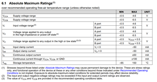

    The abs. max Io current through the TCA9406 is capped at +/- 50mA. Could you think of a case where TCA9406 would experience this amount of current through the device?
    Possibly a PU resistor that is too strong, or several PU resistors in parallel that could sink a significant amount of current through the TCA9406? Any I2C switches in the system (TCA9548A for example)?

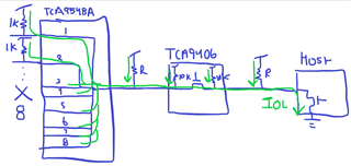

  • Hi Colin,
    Since the TCA9548A switch can have 8 channels on at a single time, a circuit could look like this when pulling LOW.
    In this rough drawing, if you had 8 x 1k PU resistors on each downstream channel of the I2C switch, the equivalent parallel resistance is already 125ohms.
    However, it is most likely the case that the host becomes damaged before the TCA9406.
    Is the TCA9406 connected to long cabling? Long cables could introduce more inductance in the system. Maybe there are significant repeated overshoots / undershoots that could be going outside the abs. max voltage ratings.
    I pulled this image from the web,
    But something like this where undershoots occur past the -0.5V input abs. max rating for this device. It is possible that damage would occur overtime with repeated use.

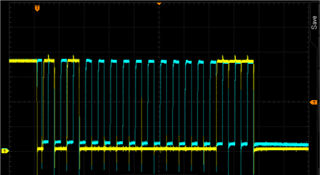

  • That is an interesting point about the undershoot. I took a look at the lines, and it doesn't seem like we are undershooting (our cable length is only around 1'), but it does look like the SCL is cross-talking onto the SDA (and vice versa), which are causing overshoots up to 0.3V above logic HIGH. The datasheet states that the maximum voltage applied to any I/O is 0.5V above VCCI. Maybe at times the crosstalk effect is even worse, and could be causing the damage?
    The effect of the crosstalk when we are at logic low is lessened by the fact that our "logic-low" is only around 0.1V instead of a solid 0V because of the cascaded n-channel pass-gate (from the 2 TCA9406 devices we have on the line). So, we are only reaching about -0.2V.

    As long as the abs max conditions are respected, we can expect no damage to the device:
    Tyler
  • Thanks for your help on this. I do have one last question, what would you recommend for reducing the effect of the crosstalk? Would a series resistor be appropriate?
  • Hi Colin,
    I can think about this from a PCB perspective. Avoid long parallel traces between SDA / SCL. If you have to run parallel, increase the distance between SDA and SCL (I think SCL pull LOW is what is coupling onto SDA - correct me if I am wrong here).
    Route traces in perpendicular fashion rather than parallel.
    Route on separate planes
    Use a VCC or GND plane in between traces.
    From a non-PCB perspective, If possible, reduce the drive strength of SCL in the host controller (this is not applicable to every controller).
    This link seems to be helpful for avoiding x-talk:
    The best crosstalk reduction techniques
    I think series resistance would help with overshoots and undershoots. Adding series resistance to the inputs of the TCA9406 would help to dampen the signal overshoots and undershoots from inductive cabling. I don't think series resistance has a complete affect on x-talk but might help?
