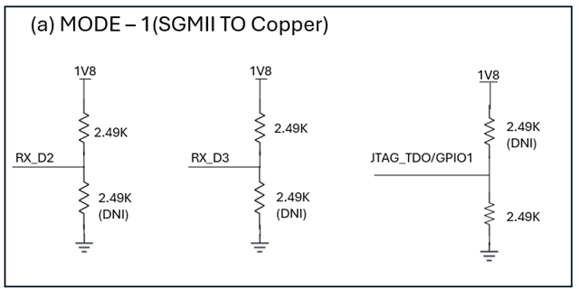

Please confirm the correctness of the below strap configuration for SGMII(or 1000Base1000Base-KX) to 1000Base-T conversion.
Figure (a) for DP83869HM functional mode selection.

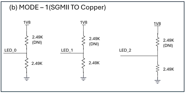

Figure (b) for DP83869HM LED configuration.

    Figure a is correct for SGMII to copper.
    Note that to do fiber to copper media conversion mode, the strapping options are as follows:
    RX_D2 in mode 1
    RX_D1 in mode 0
    JTAG_TDO/GPIO_1 in mode 0.

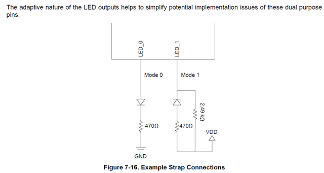

    For figure b, this is correct to enable auto-negotiation at 1000/100/10M speed with auto-MDI-X feature.
    Should you wish to use LED, the following configuration is needed in addition to the strapping configuration:
