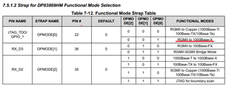

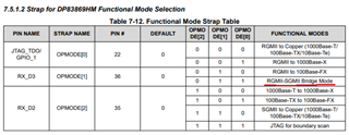

  • I have set OP_MD[2:0]=010 it didn't detect but when I connected the strap to OP_MD0 (high), the LED0 lit up which is odd.
    If you are setting OPMODE[2:0] to 011 the device will be in RGMII-SGMII bridge mode. This repurposes the fiber connections into SGMII connections, which wouldn't be valid on the EVM. I wouldn't rely on LED_0 for the correct status in this case:

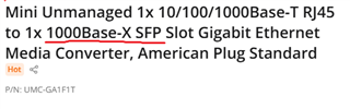

    I see from the UMC-GA1F1T product description that it supports 1000Base-X, not 100Base-FX.
    In this case, you should set the Fiber EVM to OPMODE[2:0] = 001. I believe this is the issue with linking up on the Fiber EVM side.
    For the RGMII-Copper EVM, keep the working configuration you're currently using (all LEDs set to 0).
    Just for clarification, I have set OP_MD[2:0] = 010, where only OP_MD1 is high to set it to 100Mbps-RGMII operation.
    Yes, for 100Mbps I got separate module - SFP-FE-BX (100BASE SFP 1550/1310nm) AND ANOTHER IS SFP-FE-BX (100BASE SFP 1310/1550nm) . I have tested this connected directly to host without using DP83869EVM and I was able to ping properly using UMC-GA1F1T. (I connected two UMC-GA1F1T back to back with 100Mbps SFP module in it PC<->UMC1 (Cu-Fiber)<->UMC2(Fiber-Cu)<->Host-SK-AM62B-P1 with static IP, and I was able to ping)
