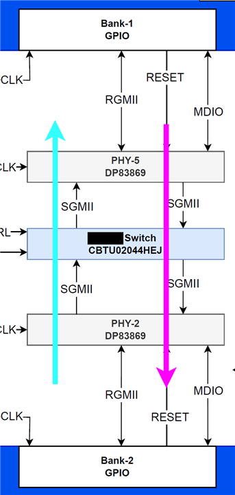

I am currently troubleshooting a design where we are trying to establish unidirectional communication between two FPGAs using PHYs in a SGMII back-to-back configuration. The unidirectional communication is enforced by disconnecting the RX SGMII diff pairs corresponding to the FPGA that is transmitting data.
We have probed the TX clock signals for the FPGAs using an oscilloscope and the measured frequency is 125 MHz. This is correct because the MAC interfaces have a configured link speed of 1000 Mbps. The RX clock signals for the PHYs have a frequency of 2.5 MHz, which I'm assuming means no link has been established or there is some other issue going on.

    1. The block diagram looks feasible using SGMII-RGMII bridge mode on the DP83869s, though you shouldn't disconnect the SGMII receiving lines. Both SGMII and RGMII are bidirectional interfaces. Forcing these to be unidirectional will likely violate their specs
    2. No, You should connect both the transmitting and receiving lines to the PHY for proper data transfer.

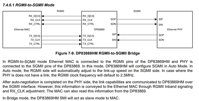

    In RGMII-SGMII mode the RGMII interface will adjust to the SGMII interface speed. The SGMII interface speed will be determined through SGMII auto negotiation. In this mode the RX_CLK will default to 2.5MHz if there is no link on the SGMII side. I believe this is what you were seeing previously:
    In SGMII-RGMII mode the roles get reversed. The SGMII interface adjusts to meet the RGMII interface speed, so the RGMII link needs to establish first.

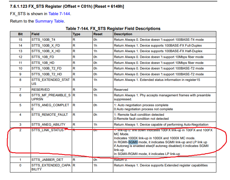

    Additionally, the link status is not shown in 01h when in an MII bridge mode. To see the correct link status, check register 0x0C01 [2]:

  • Hi Shane, do you know if it's even possible to get two of these PHYs connected back through SGMII with both of them strapped for SGMII-RGMII mode?
    The setup is as follows:
    - FPGA A's EMAC connected to PHY A through RGMII
    - PHY A connected to PHY B through SGMII
    - PHY B connected to FPGA B's EMAC through RGMII
    - Both PHYs are strapped for SGMII-RGMII mode.
    Would such a setup work with these PHYs?

  • Hi Phillipie,
    Yes this configuration is valid.
    I'm not clear what the issue is that you're seeing. The only symptom I've seen is that the RX_CLK signal is 2.5MHz, which would be expected in RGMII-SGMII mode.

  • Ok. Thank you for confirming that our setup is valid.
    I will provide more context.
    - RGMII-SGMII mode: We confirmed the strapping on both of them by reading the register 0x1DF.
    - We turned off autonegotiation by writing to register 0xC00. Some progress was made as we noticed the link LED turning on and the activity LED blinking whenever we attempt to send traffic through. We also measured the RX_CLK to be 125MHz.
    However we are not able to receive data on both ends at our EMAC within the FPGA.
    Earlier, we were able to confirm that the RGMII interface between the FPGA's EMAC and the PHY was correct by temporarily tying the SGMII interface to an SFP cage on a separate board with the help of our tech. We were able send and receive traffic to the SFP module in the cage.
    Is there a step that we are missing to get the two PHYs to communicate appropriately?
  • Are the link and activity leds turning on for both connected PHYs or only one PHY?
    It sounds like the RGMII->SGMII connection works, so the next step would be to check the SGMII->SGMII connection. If both PHYs are showing link up then this ought to be valid. To confirm this, I suggest reading the STTS_LINK_STATUS register in both PHYs as well.
    Shane
  • We indeed read the status register 0xC01 and it reported that link was up for both PHYs.

  • After SGMII link is up (LEDs solid on) are both PHY's RX_CLK outputs still 2.5MHz?
    2.5MHz is expected while there is no link on SGMII, however the speed should increase after the SGMII link is up
