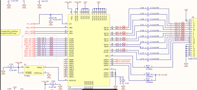

Hi everyone,
I'm working on interfacing a TI SN65DSI86 DSI-to-eDP bridge chip with a Raspberry Pi Compute Module 4 and an NT156FHM-N41 eDP panel.
I've successfully verified the data path by displaying a test bar pattern on the panel, so the basic connectivity seems okay. However, I'm running into an issue with the AUX channel communication between the bridge chip and the panel.
Here's the situation:
  • The eDP protocol uses AUX lines (AUX_P/N) for control communication, including EDID and DPCD retrieval.
  • The Linux kernel driver on the Raspberry Pi attempts to use this AUX channel to get the EDID information for display initialization. This is currently failing, and the display pipeline isn't being set up.
  • I've written simple scripts to directly communicate with the panel via the bridge to read EDID and DPCD, but these are also failing to receive any data. This strongly suggests a problem with the AUX communication itself.
  • I've already tried swapping the AUX_P and AUX_N wires with no change.
The panel I'm using is the NT156FHM-N41 (datasheet: BOE NT156FHM-N41). I'm looking for suggestions on what to investigate next to get the AUX communication working.
Could there be specific hardware considerations (like termination, pull-ups, signal integrity) I should be looking at? Are there any specific configuration settings on the SN65DSI86 that are crucial for AUX communication? Any insights or experiences with similar setups would be greatly appreciated!
Thanks in advance for your help!

  • Hello Bhavin,
    Have you probed and observed activity on the AUX channel whenever the transactions are initiated? Please check the waveforms to confirm there is activity over the aux channel.
    Please check the datasheet direct and indirect methods for I2C over aux: "8.4.5.3 I2C-Over-AUX" section. Which method are you using? Could you share the script for how you are initiating these steps.
    What mode of DP link training is used for your system? Is the AUX used for link training in the mode you have set up?
    Ikram
  • Not yet, we wanted to confirm our software configuration first. We'll do the probing.
    Yes, we are following indirect methods in our test scripts. I am adding the scripts below
    We used semi-auto link training for test patterns as suggested in the SN65DSI86 programming guide by TI.
    Our Aim is to interface the mentioned edp panel to Raspberry Pi over the DSI port by using this bridge chip. From the Linux kernel driver, we would like to utilise the existing sn65dsi86.c(https://github.com/raspberrypi/linux/blob/rpi-6.6.y/drivers/gpu/drm/bridge/ti-sn65dsi86.c) driver and panel-edp.c(https://github.com/raspberrypi/linux/blob/rpi-6.6.y/drivers/gpu/drm/panel/panel-edp.c) driver. While configuring those drivers, we are seeing the panel driver is failing to read EDID and to confirm that, we tried with the test scripts, which gave the same results, EDID read as all zeros.
    Our understanding is that this driver should work out of the box with the correct configuration made as suggested in the device trees Documentation(https://github.com/raspberrypi/linux/blob/rpi-6.6.y/Documentation/devicetree/bindings/display/bridge/ti%2Csn65dsi86.yaml).

  • Please find my inline replies below,
    1. I am not familiar with the driver code that you shared. Could you tell us where you got this?
    It is the same driver you pointed out. The driver reference you shared is from the mainline kernel, and the one we use is the official version of Raspberry Pi created from the Linux kernel for Raspberry Pi use cases.
    2. For the I2C over aux steps, please give me 1-2 days to check the "EDID_read" scripts you shared and to match it with the datasheet.
    Yes please, have a look and let us know. Please note EDID_read.sh and EDID_read2.sh are somewhat similar; the only difference is in EDID_read2.sh we are only reading the first 16 bytes.
    Also, you are using the TI EVM to test the DSI86 part right?
    No, we have our custom PCB having this bridge chip interfaced with Raspberry Pi CM4 DSI1 port.

  • Hi Bhavin,
    I am sorry for the delay on this. From the "EDID_read2.sh" script, it seems you are setting the AUX_ADDR to 0x30, not 0x50. Is this correct for your application?
    Also, you are setting 0x78 to 0x91, instead of 0x41. Can you use the AUX_CMD  = 0x4 for "I2C-Over-Aux Write MOT = 1" option instead?
    This previous E2E has a small portion of the code at the end: https://e2e.ti.com/support/interface-group/interface/f/interface-forum/957141/sn65dsi86-q1-i2c-detection-problem
    Also, if your system allowed clock stretching, then you can consider using the Direct method to simplify the sequence.
    Ikram
