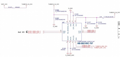

our schematic layout:
We are currently evaluating TUSB216, but due to sample availability, we are conducting preliminary I²C functionality testing using the similar TUSB214 device.

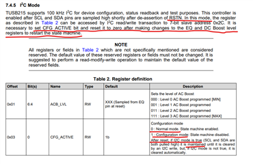

1. Unexpected Initial Value of Register 0x03 (CFG_ACTIVE) after RESET
According to the datasheet (section 7.4.5) and another thread in forum (see Ryan Kitto’s post)

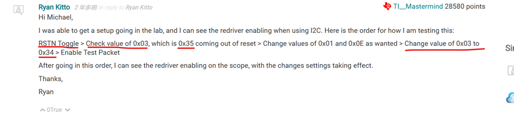

the expected behavior mentioned in thread by Ryan  and datasheet are :
  • After RSTN toggle and entering I²C mode, register 0x03 should return 0x35, meaning bit 0 is set (Configuration Mode).
  • After configuration, clear bit 0 to 0, making 0x03 = 0x34, thus enabling the state machine.

  • HI Wiser,
    I'd just like to confirm a few things on your setup. First, do you have the correct pull-ups on the SDA/SCL lines? I don't see them on the schematic, so I would like to confirm these are implemented.
    Next, when you are using I2C, before you set the CFG _Active bit to 1, what is the default value of that register? Please make sure you are only adjusting the CFG_ACTIVE bit of that register.
    What is the status of the CD/ENA_HS pins if the device is set to not active mode. Like you said, at start-up, if the SDA/SCL pins see pull-ups on the I2C lines, the device should start in I2C mode, so if it is not, it may be that the SDA/SCL pins aren't seeing the I2C lines.
    Could you confirm that you can read back any writes you make over I2C and double check they are being set?
    SDA and SCL are pulled high  ,  pull high resistors are located at other schematic around host I2C bus , and we can successfully perform I²C read/write operations (e.g., dumping and write and read back register 0x01, 0x03, 0x0E), so the device should enter I²C mode correctly

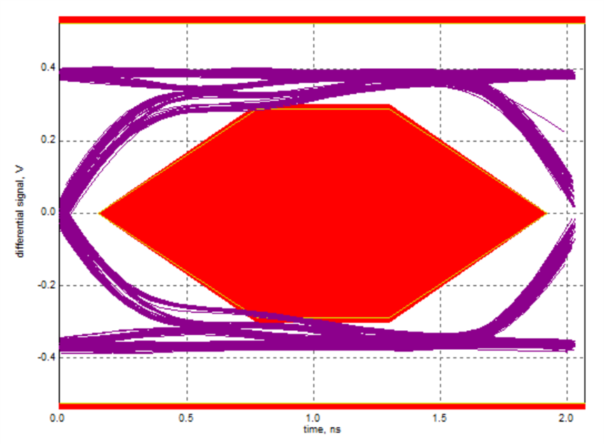

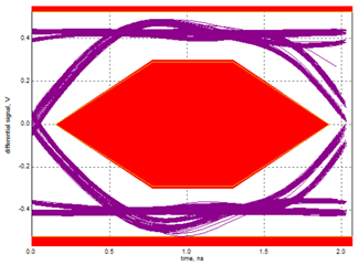

    We took some additional tests on TUSB214 comparing the behavior between pin-strap mode and I²C mode when adjusting DC Boost .
    Below are the results.
     Pin-Strap Mode Results
    When using external resistors to set DC Boost and EQ:
    • DC Boost = 80 mV (RDC1 = DNI, RDC2 = 47 kΩ), EQ0 (REQ = 100 Ω):
      ➜ The USB eye diagram shows clear signal improvement — attached scope screenshot.
      Pin Strap mode 80mV
    • DC Boost = 40 mV (RDC1 = 47 kΩ, RDC2 = DNI), EQ0 (REQ = DNI):
      ➜ The USB eye diagram again changes accordingly — attached scope screenshot.
    I²C Mode Results
    When using I²C writes to change DC Boost between 40 mV and 80 mV:
    • The I²C transactions were successful, values in registers were verified by read-back.
    • However, the USB eye diagram remains unchanged, identical to default pin-strap DC Boost = 80 mV condition, even when toggling DC Boost via I²C.

  • Hi Wiser,
    Additionally, after entering I²C mode,   initial register values by i2c read from 0x01/ 0x0e — please refer below logs  for the register dump.
    and 0x03 is 0x75 , which is keep at CFG_ACTIVE mode while entered i2c mode.
    It does look like the redriver is enabling, going by the eye diagram, so thats good. However typically, if the redriver is in I2C mode, I believe the redriver is meant to be disabled when CFG_ACTIVE is high, and then re-enable when the bit is set to 0. If changing any of the bits has no effect, then I wonder if the redriver is entering I2C mode or not. Trying this with both a TUSB216 and TUSB214EVM will help determine whether its a design or device issue potentially.
    Could you try this sequence in the meantime, to double check?
    • Disable test packets, then enable redriver
    • Adjust CFG_ACTIVE from 1 to 0, then back to 1 (optional, feel free to leave this step out)
    • Adjust the values of the registers as desired
    • Take redriver out of Config mode (1 to 0)
    • Send packets.
    You can test with some different sequencing here too, like leaving it in config mode to see if that affects performance.
      Pin Strap mode 80mV
    For these, I just want to double check the DC Boost settings. I believe the bottom eye should be the 80mV eye, and the top should be the 40mV eye, going by how they look on the eye diagrams. (More margin typically = higher DC Boost).
    Ryan

    ret = regmap_read(data->regmap, TUSB216_REG_CFG_ACTIVE, &val);
    if (on)
        val |= 0x01;
    else
        val &= ~0x01;
    ret = regmap_write(data->regmap, TUSB216_REG_CFG_ACTIVE, val);

  • Hi Wiser,
    I believe the sequencing looks good. If anything, my only recommendation would be to re-write that configuration bit just to make sure the device is in config mode.
    In both cases, the USB test packet signal remained unchanged — no visible difference on the scope.
    Just to confirm, you are turning off the test packets when you are writing to the redriver via I2C, and then re-enabling the test packets when you take the redriver out of I2C mode, correct?
    Ryan

    Hi Ryan,
    After further checking with our hardware team, we realized that in our previous tests, when adjusting the register values (DC Boost, CFG_ACTIVE), the USB chip was continuously transmitting test packets without restarting — the test packet stream was never interrupted.
    Today, we corrected our test procedure:
    • After modifying DC Boost and CFG_ACTIVE, we now stop and restart the USB test packet transmission to ensure the TUSB214 re-locks and applies the new settings.
    With this corrected procedure, we observed that when changing DC Boost from 40 mV to 80 mV, the USB eye diagram clearly shows larger amplitude — confirming that the redriver is working as expected.
    Thank you very much for your support
    Wiser
