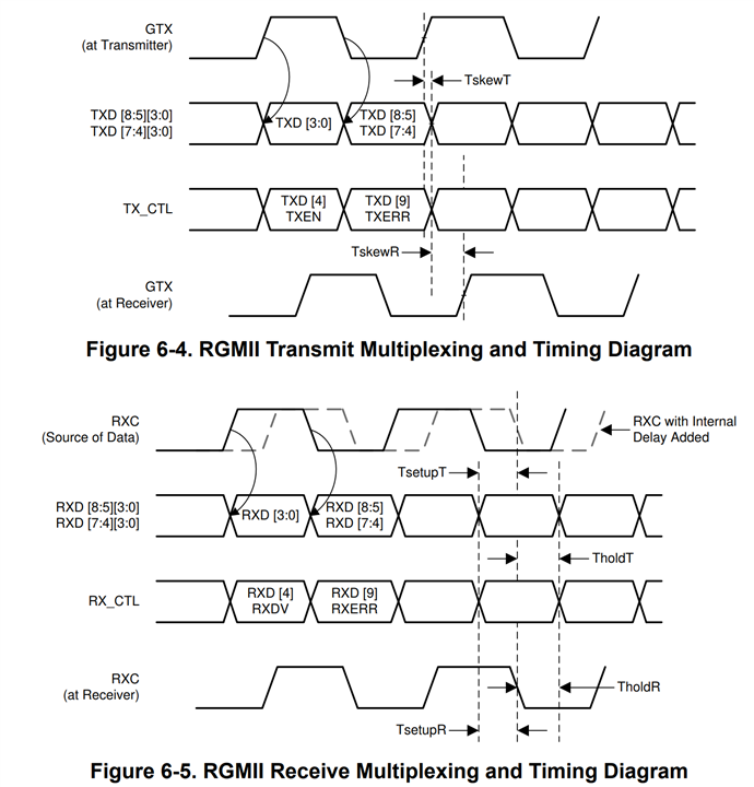

We are simulating RGMII Interface for 1Gbps speed.
Could you please provide us the following data
  1. For exciting the RX (RXC, RD0, RD1, RD2, RD3, RX_CTL) signals at RGMII PHY what is the voltage value i should consider at the Input of the PHY IBIS Model? (For 3V3 IO Model and 1V8 IO Model)
  2. How frequently does the RX_CTL and TX_CTL signals will switch, will it be same as data? from the below timing image taken from the PHY data sheet it shows that CTL signals also switch as same as data.
