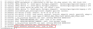

when test the system in the high temperature environment, occasionally after system reboot, from PC ping will fail,
but if do "ifconfig down/ ifconfig up" operation, ping will be Ok

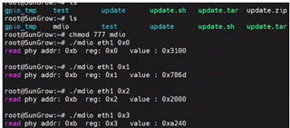

another customer with DP83822, has similiar issue, in Linux system log,
link is down, but check PHY link status of BMCR register, link is up, and if executing "ifconfig up/down", Linux link status will be up,
system will recover,
and read PHY BMSR register:
BMSR value is 0x786d, port is linkup
if plug in/out, the Linux Ethernet port link state is down
but "ifconfig eth1 down / up "can work
suspect the driver has some problem
