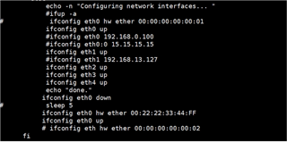

CPSW-3G 2 port is configured in Linux,
add following commands to init script
ifconfig eth0 up
ifconfig eth0 down
ifconfig eth0 hw ether 00:00:2d:3a:2a:28
ifconfig eth0 up

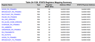

from the TRM, there is one group traffic stats register, in AM5716, there is no traffic stats register for each port?

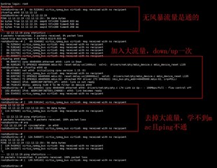

    env3_start_2024-08-19_19-01-49.log
    please check the log from customer Sungrow
    the problem is that during Linux boot up, send full speed traffic to the ethernet port as the background traffic, ifconfig up/ifconfig down/change MAC address/ifconfig up/, this operation procedure will cause network port
    abnormal, even remove the background traffic after port linkup, network can not recover
       Semon

         IP address is configured after change MAC address, at the beginning, IP adress is not configured
        with following script added to /etc/network/interfaces, send full speed traffic to the port, and reboot the board,
    after Linux bring up, remove the network storm traffic, ping this port from PC, ping failed,
    capture at the eth0 of the board, frame can be sent out to the PC, but can't receive traffic from outside,
       Semon

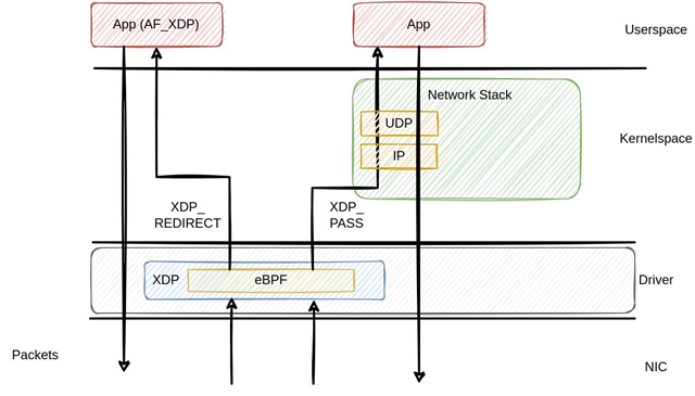

    Enabling XDP fixing the issue makes sense, because what XDP does is it bypasses the network stack that does some IP address check like below diagram I found online:

    The XDP feature fixing the issue further supports my theory, since that allows bypassing the network stack as a whole, so it bypasses the IP and UDP/TCP layers as well.
