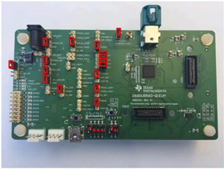

DS90UB960-Q1EVM: Unable to bring up iMX390 camera using SK-TDA4VM and DS90UB960
Part Number: DS90UB960-Q1EVM
Other Parts Discussed in Thread: SK-TDA4VM, TDA4VM
Hi experts,
I’m working with the SK-TDA4VM platform and trying to use the iMX390 camera through the DS90UB960-Q1EVM. The camera is detected successfully, but it cannot open or stream properly.
I tried using the following command, and you can see that V4L2 indicates the stream has turned on. However, there is no actual camera data flowing in.
root@tda4vm-sk:/opt/edgeai-gst-apps# v4l2-ctl -d3 --set-fmt-video=width=1936,height=1100,pixelformat=RG12      --stream-mmap --stream-count=10 --stream-to=/dev/null --verbose

Here is our media-ctl with SK-TDA4VM + DS90UB960Q1-EVM + RCM imx390

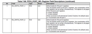

  • Hi Kathy,
    Are you able to access I2C registers for both the 960 deserializer and the 953 serializer connected to the camera? Can you share full register dumps of both devices for me to review? Make sure the correct FPD port is selected in register 0x4c before dumping register values. For example, if the SER/camera are connected to 960 FPD port 0, write 0x4c=0x01 before dumping registers.
    Lucas
  • Hi Lucas,
    Thanks for your message.
    Based on the device tree configuration, I’ve confirmed the I2C addresses of the devices as follows:
            UB960: 0x3D
            UB953: 0x44
    Here is our result of UB960 and UB953
    root@tda4vm-sk:/opt/edgeai-gst-apps# i2cdump -f -y 6 0x3d
    No size specified (using byte-data access)
         0  1  2  3  4  5  6  7  8  9  a  b  c  d  e  f    0123456789abcdef
    00: 7a 00 1e 40 d0 01 00 fe 1c 10 7a 7a 01 b9 00 ff    z.?@??.???zz??..
    10: 00 00 00 00 00 00 00 00 00 00 00 00 00 00 04 00    ..............?.
    20: f0 03 00 00 00 00 00 00 00 00 00 00 00 00 00 00    ??..............
    30: 00 00 01 42 00 00 00 00 00 00 00 00 00 00 00 00    ..?B............
    40: 00 a9 71 01 00 00 20 00 00 00 00 12 01 03 04 64    .?q?.. ....????d
    50: ff 00 00 03 00 00 00 00 5e 00 00 30 88 34 00 00    ...?....^..0?4..
    60: 00 00 00 00 00 94 00 00 00 00 00 00 00 7c 88 88    .....?.......|??
    70: 2b 2c e4 00 00 00 00 c5 00 01 00 00 20 00 00 00    +,?....?.?.. ...

    • Which port configuration is used? Is it FPD3 sync or async mode? Can you share the resistor strap on the 960 and the 953?
      • We are using Port 0 of the 960 in FPD-Link III asynchronous mode. There is only one 953/camera connected.
    • Can you confirm that the camera is powered on and sending video data to the 953?
      • Here is our hardware configuration below the picture. All the pin is default.
      • 953 is bounding the camera(RCM-imx390)
    • Can you confirm that the 953 is connected to the 960 RX port 0? Can you confirm there is only one 953/camera connected to the 960?
      • The camera is powered and the serializer link is locked (0x4D = 0x03), but it is unclear if video data is being sent. We suspect the IMX390 may not be streaming yet.

    3. CSI Lane Count and Continuous Clock
            We checked 960 register 0x33, the current value is 0x42.
                    Based on the datasheet, this translates to:
                    Bit 5:4 = 01 → 3-lane CSI output
                    Bit 1 = 1 → CSI-2 continuous clock enabled
    This matches your recommendation for 3-lane operation with continuous clock.
    TDA4VM Receiver Settings
            Regarding the TDA4VM CSI receiver settings for lane rate and continuous clock, I'd like to clarify how to properly confirm this.
            From my understanding, on the 960 side, we can check register 0x1F to verify the configured CSI lane rate.
    Kathy
  • Hi Kathy,
    Thank you for your clarifications regarding FPD3 sync mode and IMX390 I2C address.
    Regarding register 0x33 setting: a value of 0x42 sets bit 6=b1 to enable skew calibration, bits 5:4=b00 for 4 CSI lanes. I did make one mistake, bit 0 should be asserted to enable CSI output. Can you try writing the following registers to configure and enable forwarding and CSI output?
    • WriteI2C(0x7a, 0x32, 0x01) #select CSI port 0
    • WriteI2C(0x7a, 0x33, 0x53) #enable CSI output
    • WritieI2C(0x7a, 0x20, 0xe0) #enable forwarding from RX port 0 to CSI port 0
    I recommend asking the TDA4VM team for assistance with configuring CSI receiver settings. I am part of FPD-Link team and support 960 and 953 devices, but I am not familiar with how to configure TDA4VM.
    On the 960 side, your understanding is correct. CSI lane rate is configured in register 0x1F.
    Lucas
  • Hi Lucas,
    Thank you for updated register settings.
    I've tested the updated settings you provided, but unfortunately, the issue remains unresolved—I'm still not seeing any data stream into the TDA4VM.
    For your reference, here are the steps I've performed to verify the procedure:
    Booted the device using TI's official imx390-rcm DTB file.
    After boot-up, I updated the registers you provided using the following I2C commands:
    i2cset -f -y 6 0x3d 0x32 0x01
    i2cset -f -y 6 0x3d 0x33 0x53
    i2cset -f -y 6 0x3d 0x20 0xe0
    Conducted testing using V4L2 to verify data streaming into the TDA4VM.
    v4l2-ctl -d3 --set-fmt-video=width=1936,height=1100,pixelformat=RG12 --stream-mmap --stream-to=/dev/null --verbose
    Could you please confirm if my approach is correct, or if I might have missed anything?
    Additionally, could you help forward my query or introduce me to the appropriate contact on the TDA4VM team for further assistance with CSI receiver configuration?
    Thanks again for your continued support!
    Kathy
  • Hi Kathy,
    Your procedure seems correct to me. Let me investigate further and get back to you with next steps.
    You can reach the TDA4VM team by opening a new E2E thread with the correct part number.
    Lucas
  • Hi Kathy,
    Apologies for the delay. Can you share the imx390-rcm DTB file you are using? I'd like to review and run a similar setup in my lab.
    Lucas
