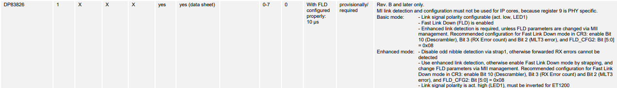

The DP83869HM is listed for "EtherCAT G (1,000 Mbit/s)" but NOT for "EtherCAT (100 Mbit/s)" in Beckhoff's PHY selection guide.
On the other hand, DP83826 is listed for "EtherCAT (100 Mbit/s)" in Beckhoff's PHY selection guide.
download.beckhoff.com/.../an_phy_selection_guidev3.1.pdf
In addition, the DP83826 provides an application note for "EtherCAT (100 Mbit/s)".
