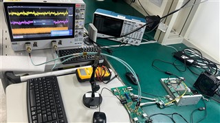

嗨,TI 團隊,
我們已經使用 TekExpress 成功設定了 SPE 測試環境,現在我們可以執行測試模式 1~7,如所附螢幕截圖 test environment.jpg 所示。
我們希望您能就模式 1 和模式 4 的一些失敗結果和問題提供協助。以下是我們的客製化專案板 (X303-EC) 和 CRB 參考板之間的比較:
模式 1 → 無波形輸出,無法進行測試。 CRB 也會出現此問題。
模式 2 → X303-EC 測試結果為失敗;CRB 測試結果為通過。然而,誤差幅度僅 ~0.02。
模式 4 → 無法測試。根據軟體 SOP,此測試需要特殊夾具。 CRB 也存在同樣的問題。
模式 5 → 結果失敗,與 CRB 相同。
模式 6 → 通過,結果與 CRB 相同。
我們將非常感謝您就以下事項提供指導:
  1. 模式 1 和模式 4 是否有任何已知問題或其他要求?
  2. 您能否確認在每種測試模式下波形擷取的正確偵測位置(例如,TRD_P/N或其他) ?

  • Hi Jim,
    这是国际 E2E 论坛。为了让我们队员看懂你的帖子,请用英文写,谢谢。
    (This is the international E2E forum. To allow our team members to understand your posts, please write in English, thanks).
    __________________
    The configuration of the DP83TG720 for compliance testing is described in an application note (https://www.ti.com/lit/an/snla371b/snla371b.pdf). After the power up of the DP83TG720, it must be programmed with the master or slave initialization script described in Section 3 to optimize the electrical performance - please perform this initialization if it is not already part of your procedure. Then after this, the test modes can be configured.
    > Mode 1 → No waveform output, no test possible. The CRB also has this issue.
    The notes from Section 4 regarding Test Mode 1 say that 1) there must be a link between the DP83TG720 and the link partner before running the test, and 2) the clock signal used for the test is exposed on the CLKOUT pin of the DP83TG720. Can you verify that there is a link partner, the link is up, and the CLKOUT signal from the PHY is being measured?
    > Mode 2 → X303-EC test result is fail; CRB test result is pass. However, the error magnitude is only ~0.02.
    Test mode 2 is used for the MDI jitter test. If it works on the TI board but the customer board has issues then likely the failure is related to some part of the layout design of the customer board. Since the failure is so marginal it could also be helpful to run the test several times or see if there is something that can be tightened/optimized in the test setup.
    > Mode 4 → Unable to test. This test requires special fixtures according to the software SOP. The same issue applies to CRB.
    OK, this sounds like a hardware limitation. I am not sure we can provide any advice to assist with this.
    > Mode 5 → Result failed, same as CRB.
    Test mode 5 is used for the power spectral density (PSD) test. One common reason for failing PSD is that there could be too much insertion loss between the PHY and the scope. If it is possible to shorten the cables or use fewer connector stages, it could help improve the test results. Otherwise, it is a matter of layout.
    > Mode 6 → Pass, the result is the same as CRB.
    OK.
    In general, I recommend that you review the PHY initialization and test procedures to make sure they are following our recommendations, then see if any improvements can be made to the test fixture. If there are still issues after this we can help you review the layout of the customer PCB.
    Evan Su
