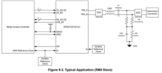

Why this DP83TC814R-Q1 is not isolated one?
How isolation is taken care because we cannot use RJ45 connector here right ? RMII slave mode 100 Base T1 mode?

Hi Nayan,
Isolation is facilitated by DC block caps and CMC.
Single pair ethernet does not use RJ45 since RJ45 has 4 differential pairs and single pair ethernet has 1 differential pair.
