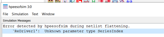

Hi Brain,
Simulation is carried out ADS tool for same IBIS-AMI model, But we are getting some error in the model.
Kindly check on this.
tp use the example ADS but when I open the redriver AMI IBIS model this is the error I get.
ERROR: (deeditutil2.ael line 3859, column 12 in dm_form_get_label)
Parameter 1 of dm_form_get_label is NULL. Expected formDef.
Haripriya S M
Hi Haripriya
This model do has issue and we reported to dedign team, but not sure when we can get feedback due to design resource issue.
But we do have an alternative way to estimate if design is good or not.
below is the excel sheet, you need to select limited redriver sheet and key in the data rate and PCB trace length, it will give you the right EQ setting.
1738.RX & TX trace length budgeting.xlsx
