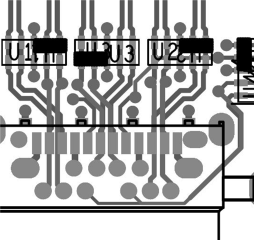

As per TMDS1204 datasheet, the ESD part mentioned is PUSB3FR4 IC. In this IC, i have connected the Data lines and clock lines which is going to GPU and HDMI TX connector.
Only 4 channels are available in this ESD IC. Balance 4 NC pins are there in the IC. If I had connected the Data signals to the NC pins, will it work. Please reference below image, how I am planning to do and provide your feedback.
