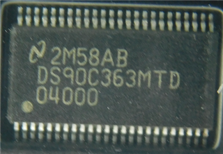

Hi team, could you please tell me how to decipher lotcode and datacode for this component?

Hi Pierre,
We usually do not publicly share the code scheme information. Could you tell us why you need this information?
Ikram
We need to interpret the lot- and date-code information for incoming-inspection and counterfeit-avoidance purposes
Pierre

Hi Pierre,
The top line contains year and month data code along with assembly site and lot code. So the code will vary for different lots and batches.
If you want to confirm whether this is from TI, the only way would be to share the LTC (lot trace code) and we could check it with our lot tracking tools.
You can find more information here about ordering and authorized sources: https://www.ti.com/support-quality/quality-policies-procedures/anti-counterfeit.html
