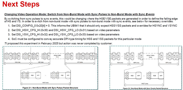

    The specific modifications are as follows:
    1. Change the DSI output mode at the SOC side to non-burst_sync_ivent mode, and ensure it works through log printing.
    2. Config 941 register, please help check is it correct?

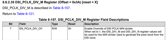

    • Set DSI_CONFIG_0 0x20[4] = 0. This informs the UB941 that it should only expect HSS/VSS packets and overrides for HSYNC and VSYNC
    • Set DSI_HSW_CFG_HI (0x30) and DSI_HSW_CFG_LO (0x31) based on video parameters
    • Set DSI_VSW_CFG_HI (0x32) and DSI_VSW_CFG_LO (0x33) based on video parameters
    About 4. SoC must be configured to convey accurate DPI-type timing for HSS and VSS packets for this particular mode
    Does it mean to confirm whether the HSS VSS data packet was sent from the DSI data packet? Currently, there is no way to confirm the data packet, but from my understand that changing the mode will definitely change this data packet. Then, the timing content can be confirmed as follows without any problem.

    Why does this mode have an optimization effect on flashing devices compared to the previous mode?
    The Event mode programs the sync width into the device and does not rely on detecting sync HSE/VSE. The fact that this is improving performance indicates the device outputs more robust video with hard-coded sync widths and the DSI input most likely has more variation in sync widths from SOC due to either SOC behavior or system signal loss. In the pulse mode, the device is forced to rely on the HSS/HSE and VSS/VSE to detect sync widths and depending on the DSI input, this sync widths can have variation.
    What other methods can be used to optimize the vertical lines issue?
    Vertical lines usually occur as an issue at certain PCLKs. We would recommend operating at a different PCLK and see if problem goes away - however, that would not be acceptable to customer in this case. I will discuss with internal team what other actions can be taken.
    Correct
    Correct
    Yes this means SOC must send HSS/VSS packets in the DSI protocol

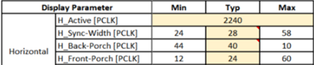

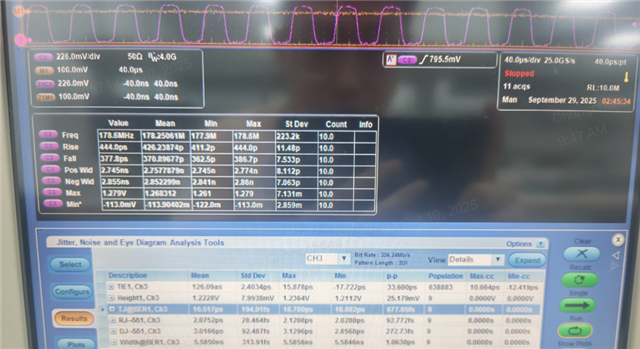

    T-CON spec as below:
    Can you share T-CON specifications? There may be a tolerance on the PCLK, we can try to vary the PCLK within the tolerance and see if video improves.
    Customer asked how can they test with this?

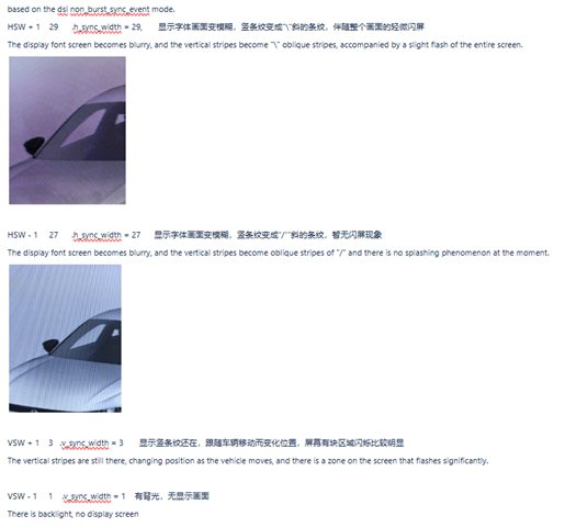

    1) Try changing the DSI settings shown in your earlier message with both the min and max timing specifications of the T-CON - specifically by modifying the blanking parameters. These settings will then have to be modified on the 941as side as well.
    Customer are trying this. For the DSI mode sync_ivent + H slot screen parameter change +  941 HSW register modification, customer said they only see the following HSW configuration. Do other porch configurations need to be configured in this mode?
    0x30 DSI_HSW_CFG_HI
    0x31 DSI_HSW_CFG_LO
    2) My second suggestion is to review the following E2E. The customer was experiencing issues with a certain color due to power requirements for a given color. Can you share an image of the vertical lines? It could potential be an issue where T-CON is having difficulty driving power for high-power pixel colors such as white. Are there certain images or colors that have the vertical lines issue and others that do not?
     https://e2e.ti.com/support/interface-group/interface/f/interface-forum/1491061/ds90ub948-q1-displayed-picture-crashes-if-the-window-is-maximised-or-moved-over-the-edge
    Customer feedback the pixel display of vertical line is not in the order of RGB, such as RGB being reversed or certain R, G, B not being displayed, and the position of vertical line will also change as display content change.

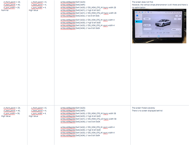

    Please configure the following:
    • 0x30-0x31 - DSI_HSW_CFG
    • 0x32-0x33 - DSI_VSW_CFG
    I would recommend ensuring EN_PCLK_DIV_OV=0 - this will ensure autodetection of PCLK and customer will not have to manually write PCLK for each change in video parameters.
    Please let me know update on testing and we will proceed forward from there (example test matrix shown below)
    Hsync Vsync
    Nominal Nominal
    High value Nominal
    Nominal High value
    High value High value
    Low value Nominal
    Nominal Low value
    Low Value Low Value

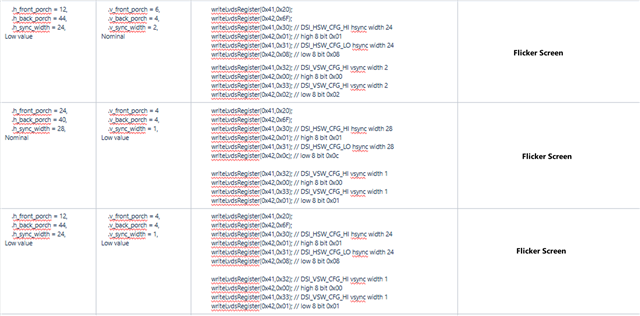

  • Hi Ragav,
    0x3A register EN_PCLK_DIV_OV bit is 0.
    Below are their test summary, seems different combination of hsync and vsync have no improvement on vertical line issue.

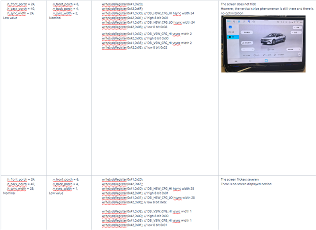

  • Hi Xiaowei, thank you for summarizing these tests results.
    I am assuming "There is no screen displayed behind" means no backlight, please correct me if this is incorrect
    Hsync Vsync Result PCLK
    Nominal Nominal No flickering / Vertical Stripe 177.98 MHz
    High Nominal Flickering + No Screen 180.27 MHz
    Nominal High No flickering / Vertical Stripe 178.26 MHz
    High High Flickering + No Screen 180.55 MHz
    Low Nominal No Flickering / Vertical Stripe 177.67 MHz
    Nominal Low Flickering + No Screen 177.84 MHz
    Low Low N/A (I do not see this screenshot) N/A
    This agrees with Ragav's second point, where the phenomena will follow the content displayed on the screen (abnormality only occurs with certain content displayed):

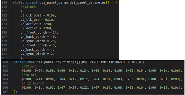

    The way the HS and VS were programmed may not match the anticipated TCON values for Low and High when using the HS, VS investigation. This may be why the flickering occurs even when the PCLK is within the TCON limitations. Here is my recommendation to try for all the cases requested by Ragav:
    When testing High Htotal values and Nominal Vtotal values, the following was used:
    However, the TCON specifies when using the max PCLK the H_Back-Porch should be reduced:
    So it should be
    .h_front_porch = 60,
    .h_back_porch = 10,
    .h_sync_width = 58,
    High Value
    .h_front_porch = 12,
    .h_back_porch = 44,
    .h_sync_width = 24,
    Low Value
    .v_front_porch = 10,
    .v_back_porch = 4,
    .v_sync_width = 4,
    High Value
    .v_front_porch = 4,
    .v_back_porch = 4,
    .v_sync_width = 1,
    Low Value
    (2) I have edited this for the rest of the configurations used, the sync widths should be correct for each case but please also make sure the SoC is sending the other correct parameters for front_porch and back_porch for the TCON.

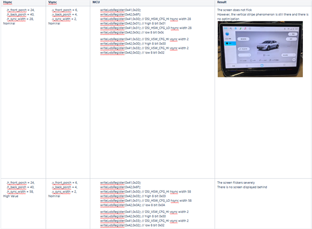

  • Hi Miguel,
    No, it means backlight is good, but no display.
    (1) Is there a way to change the pattern to be fully one color to test if the vertical line issue only happens due to a specific sent image or color from the SoC? I know the issue will not occur with SER PATGEN.
    When test with fully one color pattern, no vertical line issue.
    Internal timing and internal clk, result is good
    Internal timing and external clk, result is good
    External timing and External clk , result is abnormal

    Thanks for testing these configurations as well as confirming the different clocking uses from the 941AS.
    Thanks for testing this from SoC output, can you try color bars or other patterns to double-confirm there is not one specific color combination that causes the loss of pixels?
    What we are trying to investigate here is the content change = position of the vertical line, it is assumed there is a specific pixel pattern or combination at the RX of the device that causes the phenomena at the display side.
    Based on these tests and the timings used for each of the corrected cases, it appears that none of these configurations can achieve no flicker, is the nominal hblanking and nominal vblanking configuration still good?
    At this point, the next recommendation we can try to improve the PCLK of the input is to fine tune the register settings with nominal incoming video timings from the SoC.
    From the previous test, it appears that nominal / nominal combination has no flickering screen but still has the vertical lines.
    The suggestion is to increase/decrease the programmed DSI_HSW_CFG first by +/-1 px increments, then do the same with DSI_VSW_CFG but keeping the SoC output the same.
    • This test determines if the 941AS can fine-tune adjust the incoming PCLK to accommodate for the vertical line behavior.

    1.Using patgen test, the vertical stripes cannot be seen. The 0x64 register bit4-bit7 tried different patgen images, but no vertical stripes were seen.
    2.Adjust HSW +/- 1pixel to see the vertical stripes that change to "/" , "\" shapes.
    Adjust vsw to 1 and the screen is not displayed.
    3.In addition, adjusting the DSI working mode cannot completely solve the problem of splash screen. We also tried several other pieces to optimize the splash screen effect, but the splash screen will still occur over time.
    4.Yes, the vertical line and panel flick behavior follows ABA swap.
    Thank you for the feedback.
    Can you please try this PATGEN test from the SoC? I still am interested to know how a gradient pattern and color bars would react when received at the RX of the 941AS, to determine the dependency on pixel pattern / color.
    • This is the SER pattern, which we know will not have any issues
    Since the HSW adjust changes the shape of the stripes, I think that the nominal value should be used only with non-burst sync event mode.
    At this point we have tried several different software configurations to improve the RX CLK of the device, since the issues still occur have there been any hardware attempts to optimize the screen abnormality?
    Miguel

  • Hello Miguel:
    我们内部确认,当前只有jitter这个不满足要求,但是针对这个问题case,验证下来与external timing和941之间有关联,当使用外部时钟芯片,不使用DSI时钟时,在满足clk jitter值要求的时候,问题941还是存在竖条纹的问题,对此,您还有什么看法?
    We internally confirm that only jitter does not meet the requirements at present, but for this problem case, it is verified that it is related to external timing and 941. When using an external clock chip and not using a DSI clock, when the clk jitter value requirement is met, there is still a problem of vertical stripes in question 941. What do you think about this?

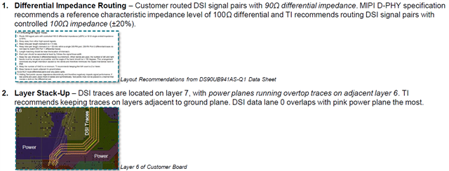

    I do believe that the issue of flickering and to some extent the vertical lines is related to the jitter specification. However, it seems the two issues are separate in their reproduction.
    One concern that is previously pointed out in the layout review involves the routing of the data trace D0 P/N, please see below.
    I think this is further supported by the following information:
    • Adding additional impedance to DSI D0 trace reduces flicker / stripe abnormality
    • Internal PATGEN of the 941AS (such as color bars) does not show the issue
    Please let me know if you have any further questions.
    Miguel

    我们在GP SOP4 PCBA上也有外部时钟芯片LMK3H0102,它输出的CLK是满足jitter clk要求的,941调整使用external ref clk后验证显示还是存在竖条纹现象。
    您描述的使用941内部画面没问题, 是否只能说明941显示输出的画面没问题,但是941作为RX接收端,接收SOC的数据是否会有问题呢?
    We also have an external clock chip LMK3H0102 on the GP SOP4 PCBA. The CLK it outputs meets the requirements of jitter clk. After adjusting the 941 refclk mode, it verifies that there is still vertical stripes after using external ref clk.
    The internal PATGEN of the 941AS does not show the issue you described can only indicate that the 941 displays the output screen, but will there be any problems with the data book receiving the SOC as the RX receiver?

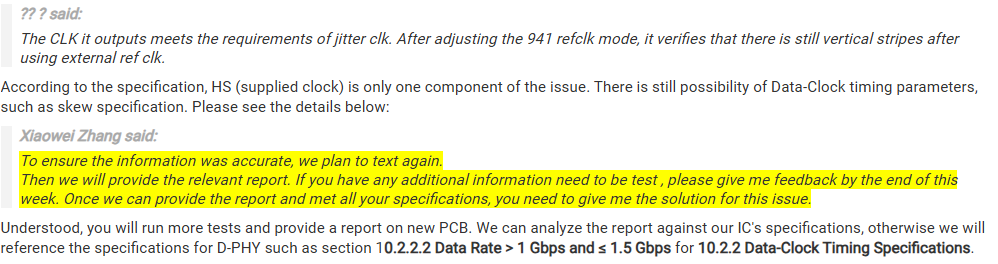

  • Hi Xiaowei,
    Thanks for providing this update,
    I would like to know more about which jitter requirement is not met.
    ABA cross-experiment, and the vertical stripe phenomenon still exists.
    This supports the earlier suggestion that the issues of the vertical stripe and the flickering are separate reproductions from the old system, as there is no mention of flicker here. We can focus on the vertical stripe as a separate issue from here.
    Differential Impedance Routing and Layer Stack Up questions have been solved.
    How does the new layout compare to the old layout? I see there may have been this internal forum related to the layout review: E2E.
    Please correct me if this is the wrong layout - but have the feedback been implemented, especially in consideration to the DSI traces and GND planes?
    In the previous thread, it can be seen on the DSI register pages that when DSI page 0x21 = 0x61, DSI_ERR_COUNT (register 0x29) is 0x0 in the normal case and 0xFF in abnormal case. Is this still consistent with the new layout as well?
    According to the specification, HS (supplied clock) is only one component of the issue. There is still possibility of Data-Clock timing parameters, such as skew specification. Please see the details below:
    To ensure the information was accurate, we plan to text again.
    Then we will provide the relevant report. If you have any additional information need to be test , please give me feedback by the end of this week. Once we can provide the report and met all your specifications, you need to give me the solution for this issue.
    Understood, you will run more tests and provide a report on new PCB. We can analyze the report against our IC's specifications, otherwise we will reference the specifications for D-PHY such as section 10.2.2.2 Data Rate > 1 Gbps and ≤ 1.5 Gbps for 10.2.2 Data-Clock Timing Specifications.

    如下是我们使用lmk3h0102芯片输出的时钟作为参考时钟给到941时测量的jitter值,这个值是符合spec要求的,但是问题竖条纹现象还是存在的,之前使用的soc dsi clock测量的jitter不符合spec.
    The following is the jitter value measured when we use the clock output by the lmk3h0102 chip as the reference clock to 941. This value meets the spec requirements, but the problem of vertical stripes still exists. The jitter measured by the soc dsi clock used before does not meet the spec.
    Understood, is the SoC DSI clock outside of specifications in general or only on the previous layout?
    • Does the jitter specification meet on the new layout from the SoC?
    Additionally, the LMK3H0102 chip may provide a clean reference for the DSI CLK, but the DSI data lane may still be affected by the routing concerns that were previously mentioned from the layout. The data lane 0 may still have bit errors received at the data input in this case, which may induce the vertical stripe.
    • Has flickering been observed using LMK3H0102 reference clock?
