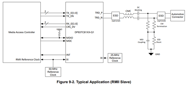

Part Number: DP83TC814R-Q1
Could you please share the reference schematic for DP83TC814R in RMII slave mode,?
Thanks in advance
Thanks in advance
Hi Meghna,
We have an example reference schematic with key RMII connections in our data sheet. We also have a schematic checklist to help with strapping and power supply networks since they are not covered in this data sheet schematic.
Does this cover your needs?
Drew
