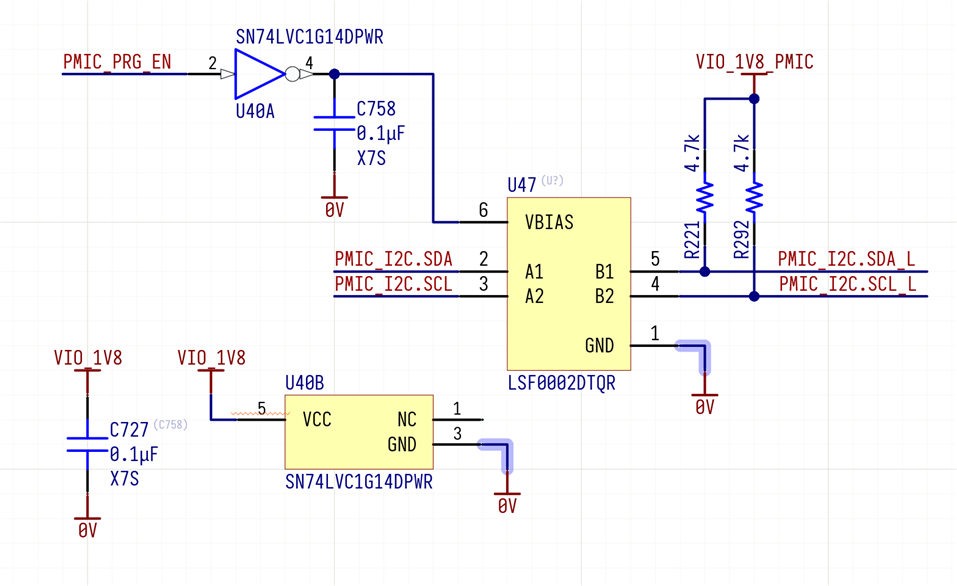

Im trying to make a switch and translator as shown in the below schematic.
During normal operation,
VIO_1V8 will be equal to VIO_1V8_PMIC.
During production programming of the PMIC, just once, the VIO_1V8_PMIC rail can be 1V8 or 3V3. And Enable pin is pulled low with a mosfet as an open drain configuration so the rest of the circuit will be disconnected on the I2C bus.
Do you see any problems with this circuit?
Also do you think LSF0002 is a better fit for this application?
