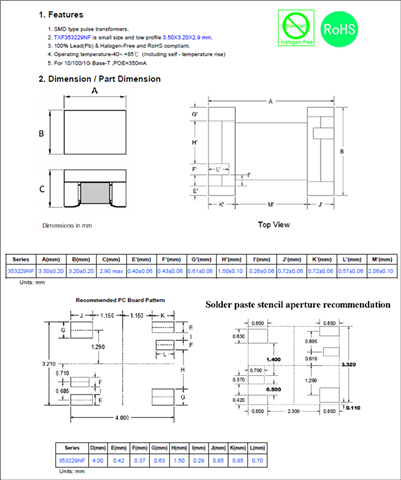

Part Number: DP83822I
Hello team,
Is below LAN XFRM SPEC able to be compatible DP83822?
Is there inductance requirement?
Hello team,
Please see this e2e FAQ for the magnetic selection, we typically recommend using 350uH inductance for the magnetic.
David
