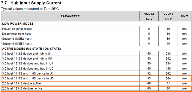

    I'm not sure I understand. When the USB3 and USB2.0 devices are connected are the functional?
    If they are both on and functioning the current draw is with expectation.

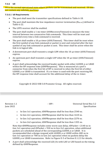

    There are different states that will control the power draw of devices connected to the hub. When I ask what state are the are the devices in id not not have anything to do with data being transferred between the hub and the device.
    USB3.2 has defined power states in sections 7.5.6 (U0), 7.5.7(U1), 7.5.8(U2), and 7.5.9(U3). I have attached a reference image here.
    We will focus on U0 as this is the state the devices are in from my understanding.
    As per the spec, data does not need to be transferred to be in the U0 state. Even if there is no data being transferred, the devices can be in the U0 state. The host must transition into lower power states. We can track what state the bus is in using a protocol analyzer, but as the devices are functional its most likely that the devices are in U0.
    The current consumption seems to be within spec.

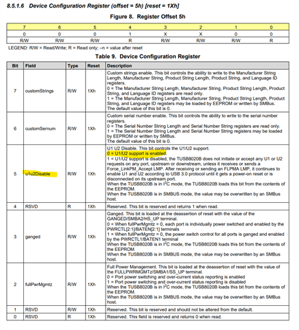

    We can have a look at this register 0x05 and make sure we have low power levels enabled.
