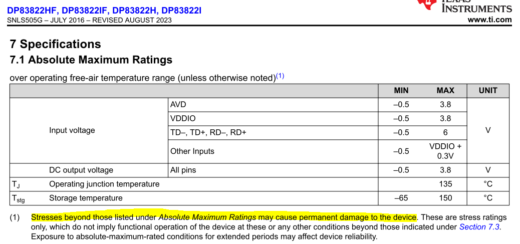

In this situation, Ethernet PHY in this computer continuously receive NLP/FLP which could have undershoot below the Absolute Maximum Rating described in the datasheet.
Undershoot may depend on board design, however, I can find some waveform which is exceeding -0.5V in E2E.
Since the device is receiving the voltage which exceeds the Absolute Maximum Rating, I am thinking that the device could be damaged.

Most of the device seems to have Absolute Maximum Rating MIN as -0.3V or -0.5V for MDI pins.

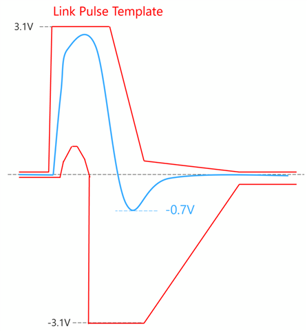

    I understand that Ethernet PHY uses magnetic between RJ45 connector and the PHY. Even if there is an isolation, I believe AC signal can pass through the transformer such as Fast Link Pulse and Normal Link Pulse (group of short pulses) to detect PHY <-> PHY connection. Since there is an signal isolation, un-powered PHY cannot provide bias voltage to the signal line which means the common mode voltage would be 0V. Since the link pulse is a short pulse, there should be at least some undershoot.
    Here is may question to your comment.
    1. So, what happens if the peak voltage of the undershoot is -0.7V (voltage under absolute maximum ratings) ?
      1. Voltage is measured at the point between PHY and magnetic, close to the PHY.
      2. In the compliance test, link pulse waveform template seems to allow -3.0V undershoot.

    The PHY internal ESD will clamp if the FLP has an undershoot, protecting the PHY from being damaged.
    Undershoot could come from impedance mismatch of the PCB design, or the loading may not be correct. But if the FLP can meet the 802.3 FLP template and pass the compliance, what is their concern?

    Below is link pulse template.
    I don't believe there is such large undershoot in general design, however, it allows down to -3.1V undershoot.
    Kawai

    We understand that there is no issue seen in this common situation in the market including competitive devices. However, there is a possibility that MDI input is exceeding the absolute maximum rating. That is why we want to clarify the specification..
    Does it mean the device can accept voltage input which exceeds absolute maximum rating down to -3.1V regarding link pulse template ? Then, what is the definition of absolute maximum rating ?
    My understanding is that any device which had voltage exceeding absolute maximum rating is damaged and can not guarantee normal operation or performance.
    If the device cannot accept any voltage under -0.5V, that means we cannot recommend user the use case of un-powered PHY cable connection with powered link partner.
    In most of the case, I believe undershoot should be lower than the absolute maximum rating.
    However, there could be a case where the device would receive the undershoot such like -0.7V (< -0.5V) based on board design, regarding the template.

    If undershoot is around -0.7V, the PHY will be ok since the internal ESD diode will protect PHY from the damage.
    But if the undershoot is below -0.7V, then we will have to test it out.
    Is this an actual issue or a theoretical question? I don't believe you will see an undershoot greater than -0.7V unless there is something wrong with the board design such as the MDI line polarity gets flipped. In this case, we should push to fix the board design to resolve the large undershoot issue.

    Though we never know about link partner link pulse behavior, we understand that PHY receiving undershoot should be inside the absolute maximum rating for device performance and quality.
