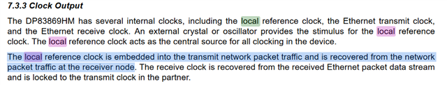

  2. In the datasheet, the term "local reference clock" is used. Does that refer to the XI input clock? If so, then it's conflicting with the text I highlighted below. The text says the local reference clock is recovered
    from the Ethernet packet.

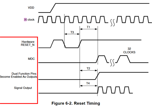

    2. I don't see other timing diagrams using the XI besides the start-up or reset, I guess it's used for the MDC? Also, what is "Signal Output" mean in Figure 6-2?

    Can you please provide more detail on the purpose of the XI input clock?
    The PHY needs 25MHz input clock on XI in all modes. This should come from a crystal or external oscillator. This clock is embedded into the transmitted network packet data. So you still need to XI to provide a clock reference to the data being sent out on the MDI bus.
    In the datasheet, the term "local reference clock" is used. Does that refer to the XI input clock? If so, then it's conflicting with the text I highlighted below. The text says the local reference clock is recovered from the Ethernet packet.
    The word can be expanded to make it clearer as shown below.
    The local reference clock or XI CLK is embedded into the transmit network packet traffic and is recovered from the network packet traffic at the receiver node of the link partner.
