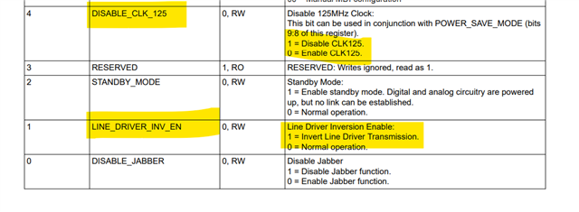

When I enable ('0') the DISABLE_CLK_125 bit (address 0x10 bit 4) I get a nice clock signals is this the same as CLK_O_DISABLE bit on register 0x0170?
By changing register 0x0170 I get 25MHz for default Reference Clock, 125MHz for transmit and recieve channels and 25Mhz for receieve channels divided by 5.
Are the recieve and transmit clocks on the CLK_OUT pin derived from the RX_CLK and TX_CLK of the MAC interface? or are they internally generated?

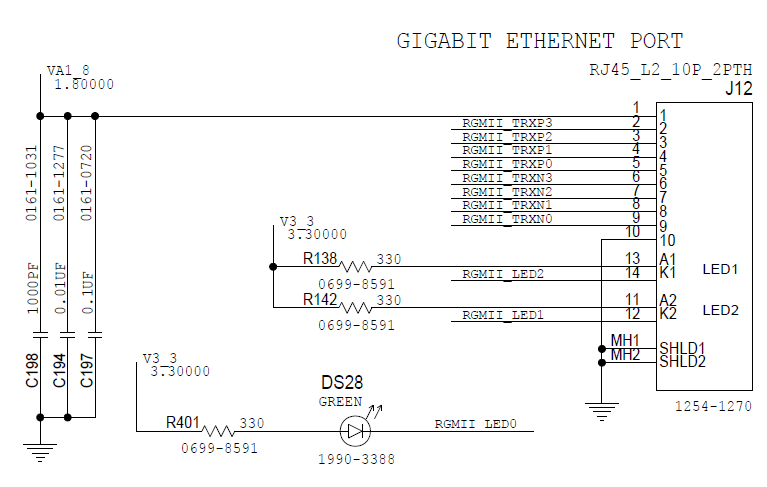

The daughterboards schematics
The motherboards schematics - Disregard the 1.8V to the tap it is floating (uninstalled resistor on another page) It was needed for the Marvell PHY.

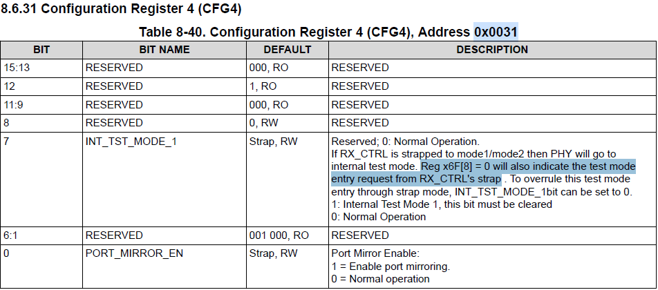

  • Some more information:
    register 0x0031 was 0x10b1 so I wrote 0 to it
    It didn't help.
    What is strange when I read it back it is 0 but there are some reserved bits that are '1' and RO and they are also '0' now.
    Why does the PHY wake up in Internal Test Mode (address 0x31 bit 7 starts up as '1' instead of '0')?
    After additional attempts at seeting normal opertational mode (instead of Internal Test Mode) we have successfully achieved acurate link status when connecting/dicsonnecting LAN cable.

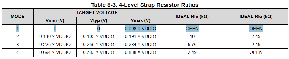

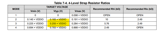

  • Why does the PHY wake up in Internal Test Mode?
    I tried configuration as in schematics (Mode 3) and also tried removing R301 and changed R300 to 2.49Kohm (Mode 4).
    In both cases the PHY starts up in "Internal Test Mode" - No cable connected. Also why is port mirroring enabled.
    In both cases register 0x0031=10B1, 0x006E=0x88A0

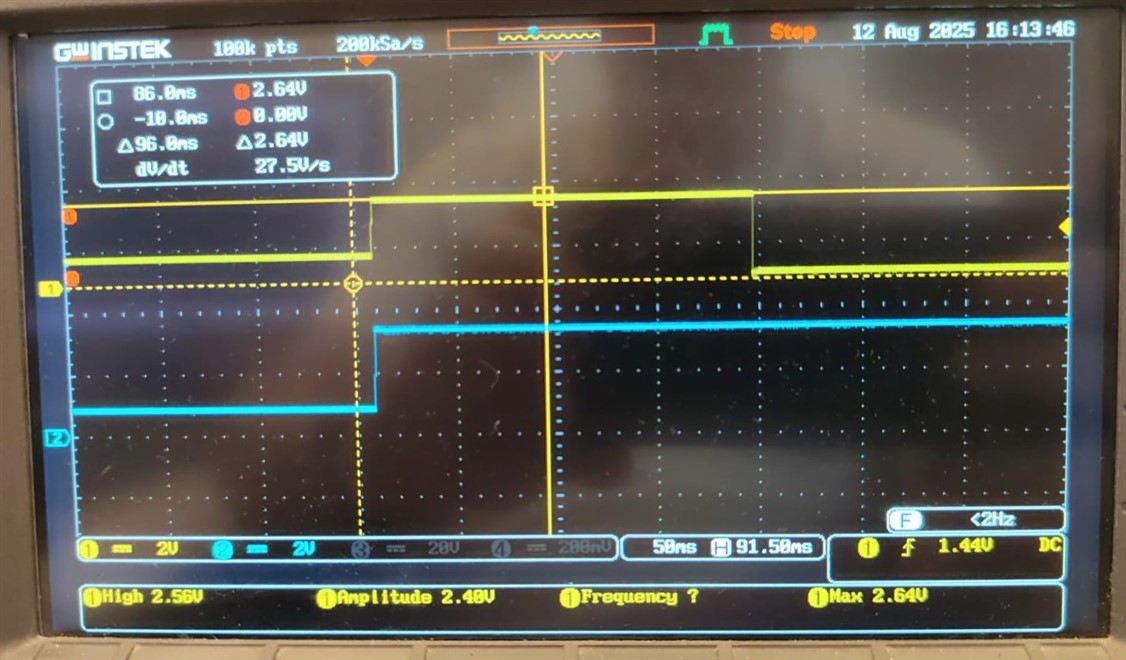

    below is scope recording of voltage for Mode 4 - Yellow RX_CTRL pin, Cyan/Blue is the 3.3v (VDDIO)
    As you can see the voltage is 2.6v which is as it should be 0.783*3.3=2.58v

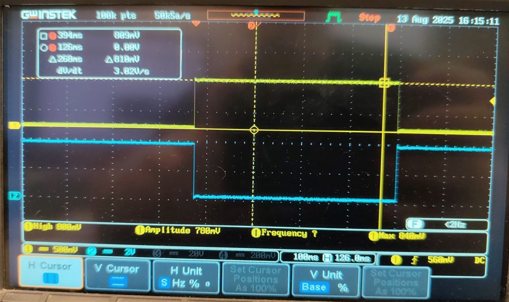

    I did an additional measurement for the RX_CTRL pin strapping for original design (Mode 3) and the results are as expected.
    Accoring to datasheet for Mode 3 the voltage should be (for VDDIO=3.3v) between voltage 0.7425v and 0.9372v. We get 0.82v which is OK
    So still no explanation why the PHY is ramping into Internal Test Mode
    I did several resets (using reset button on my board and always the same results)

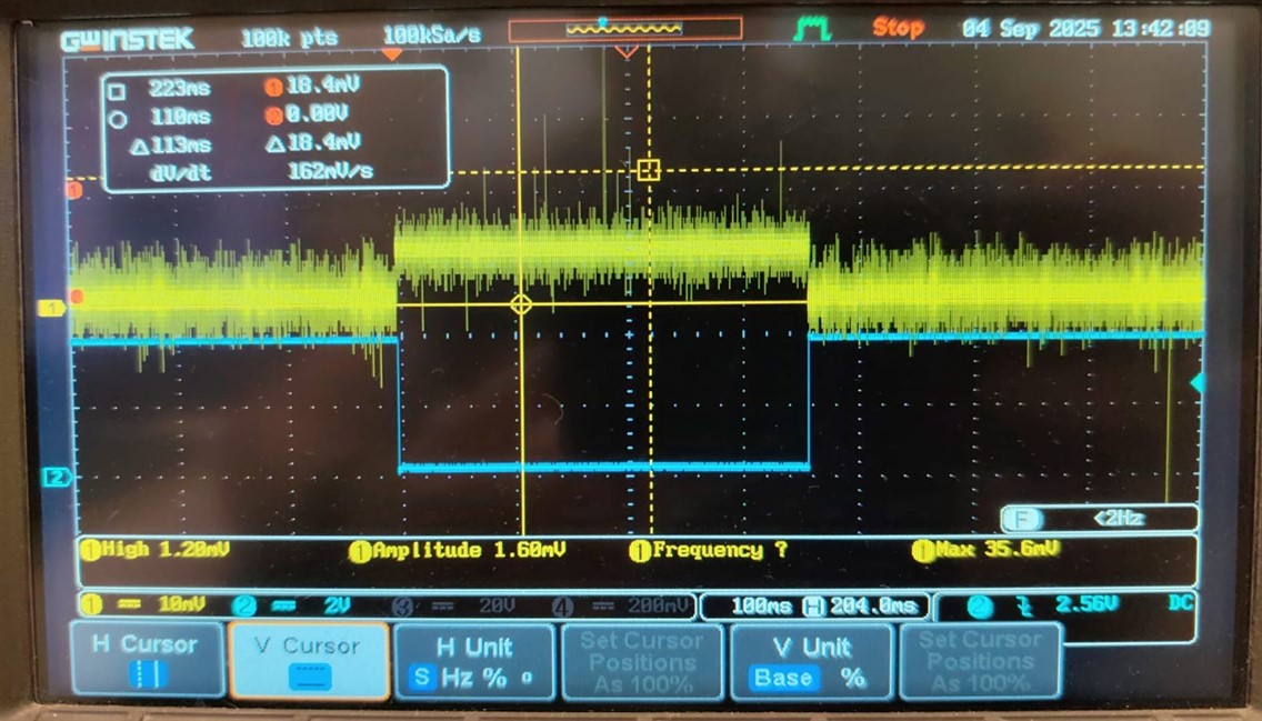

    Below is the scope readings - Yelllow is RX_CTRL, Cyan is RESET_N pin
    And zooming in on the RESET_N release time period
    Additionally, I also saw in datasheet
    I checked 0x006F = 0x0170 so bit 8 is '1' and not '0' so does that mean the request was not from RX_CTRL strapping? and if so then from where?
  • Hi Dan,
    Strapping is typically sampled 120ns after reset goes high.
    Looking at the scope shot, it looks like RX_CTRL is low around 120ns mark so this seems to be why it is being mis-strapped.
    My first guess is that the MAC/level shifter is somehow driving this line and cause this. If you isolate the RX_CTRL connection, does the PHY still enter the test mode?
    J

    I will try and strap RX_CTRL to mode 0 or mode 1 and see if the bit changes to '0' to make sure the INTERNAL TEST MODE indication is as described in the datasheet.
    So I changed the RX_CTRL to Mode 1 (OPEN, OPEN) is shown in datasheet (removed R300 and R301)
    And the scope showed as expected voltage of under 10mV (before and after reset so doesn't matter where it is actually latched) which as indicated above is consistent with mode 1.
    Register 0x31 = 10B1 (as usual) - Internal Test Mode as exprected but now also register 0x6F = 0x0070 is as expected - Bit 8 is now '0' meaning RX_CTRL strapping is not valid (Mode 1/2 and not 3/4).
    Meaning previously in Mode 3/4 when 0x6F = 0x0170 (Bit 8 was '1') the RX_CTRL strapping was OK - recognized as mode 3/4.
    Then why is the PHY ramping into Internal Test Mode?
    Also suspected LED_0 strapping so removed physical LED so LED_0 is left floating - strapping entered mode 1 (no mirroring) as expected (only modes 1 and 3 are valid) and still 0x0031 bit 7 is '1' - Internal Test Mode

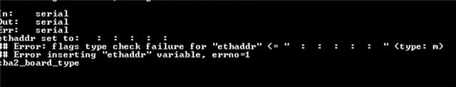

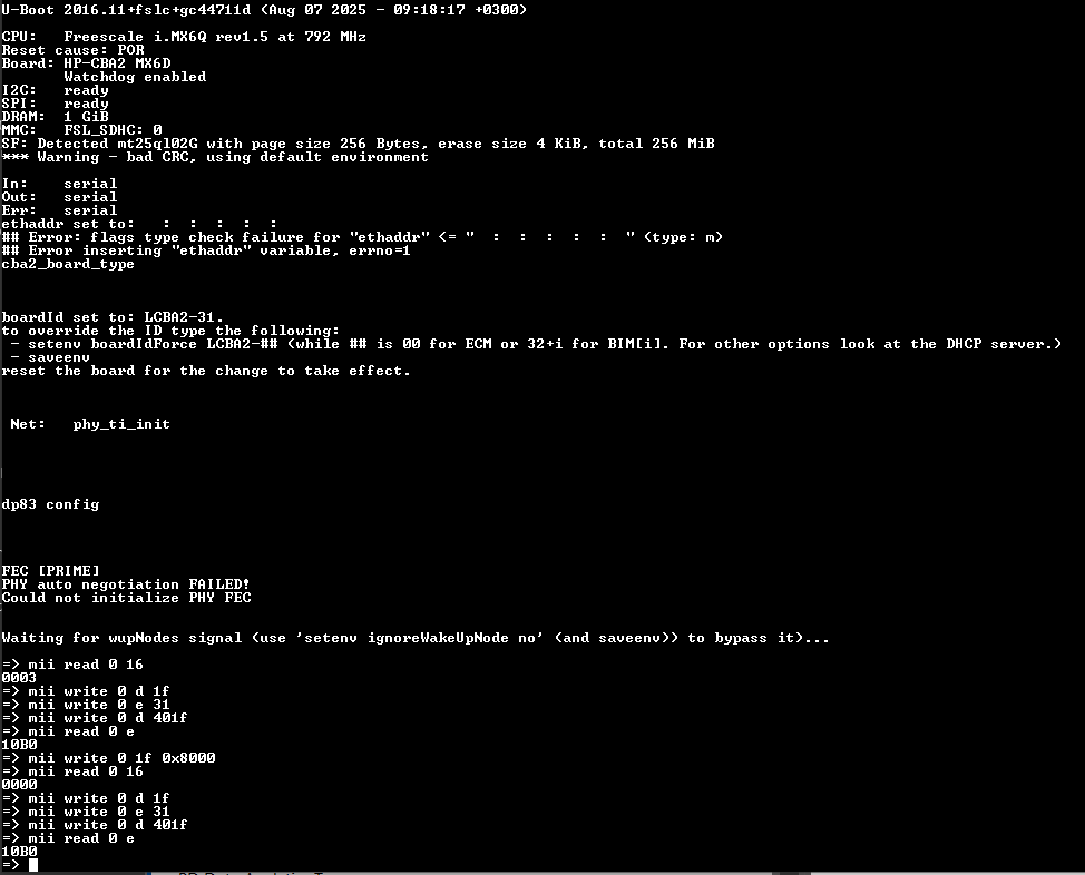

  • This is the way we recover from Internal Test Mode - given to me by SW team:
    After loading U-Boot, auto-negotiation failed, we began debugging by checking the default values of the PHY registers and found the following issues:
    • Configuration Register 4 (CFG4) at address 0x0031 was not in its default state, internal test mode and port mirror were enabled.
    • BIST Control Register (BISCR) at address 0x0016 was also not at its default value, the value was 0x3, PCS loopback was enabled, the register value was 0x3, and the speed was set to 1000 Mbps.
    After manually resetting the PHY using register 0x001f=0x8000 and clearing each register (0x0031 and 0x0016) after loading the driver in the Linux kernel, we achieved a stable connection.
    In the kernel, I set registers 0x0031 & 0x0016 to 0 in the configuration handler.
    However, after auto-negotiation completed, the BISCR register changed to a value of 0x3, to resolve this, I cleared the register again after auto-negotiation done.
     The auto-negotiation-done handler is triggered whenever the link status changes, so I cleared the registers each time the handler was called.
    I cleared register 0x0031 in the configuration handler, and since register 0x0016 changed after auto-negotiation, I cleared it each time the handler was invoked in the driver.

  • When doing a SW reset the PCS loopback changes from 0x3 to 0x0.
    Internal Test Mode is still '1' - Doesn't change.
  • Hi Dan,
    Because the SW reset properly resets register 0x0016 to 0x0000, I am suspecting that this register is not being triggered from the hardware strapping. Therefore, I suspect that the SW is somehow writing 0x3 to the 0x0016 register.
    Internal test mode being enabled will not have any impact on the functionality of the PHY. We are looking more into this internally to see why this bit is being enabled despite RX_CTRL pin is strapped to mode 3 and 4.

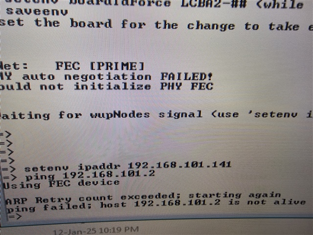

    We identified that the issue with register 0x0016 was due to the software writing 0x3 to it and this has now been resolved.
    However, we are still experiencing a problem with register 0x0031, after resetting the PHY—either by writing 0x8000 to register 0x1f or performing a normal board reset, we observe a value of 0x10B1 in register 0x0031.

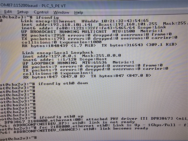

    In the Linux kernel, we clear this register in the driver within the dp83867_config_init function, Additionally, before initializing the PHY, we write 0x1012 to register 0x0010, and after this step, the PHY operates as expected in the kernel.

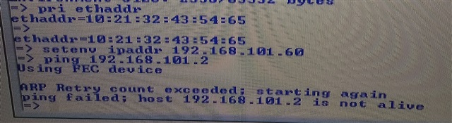

    We followed the same procedure in U-Boot, but it did not work (no ping or ARP messages!), Could you please explain why this might be happening?
    We are using U-Boot 2016.11 fslc , maybe we should use the latest?
    Wesam

    As I said in the previous post, the internal test mode should not have any impact on the PHY's functionality, but we are verifying internally to see why this is being enabled in the mode 3/4 of the RX_CTRL strap. We will keep you updated.
    When you say the PHY operates as expected in the kernel, does this mean the PHY can ping and do ARP messages?
    I looked at register 0x0010 and it looks like 0x1012 disables 125MHz clock and enables line driver inversion:
    Disabling 125MHz clock and inverting line driver will impact the PHY functionality as it does not seem like MDI lines are not reversed in the schematic and RGMII needs 125MHz clock.

    I cleared register 0x31 and then started clearing bits in register 0x10. After writing 0x5048 to register 0x10, the PHY functioned as expected.
    (I wanted to determine which bit in register 0x10 enables the PHY to function, so I cleared bits in register 0x10 for testing)
    However, according to the datasheet, bit 11 of register 0x10 is reserved and read-only!. Why does the PHY start working after clearing this bit?
    The default value is 0x5848, the new value is 0x5048.

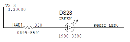

  • Regarding LED_0 I tried with DS28 physically installed and also diconnected (removed).
    With the LED the reset value was 0x5848 after writing 0x8000 to register 0x1f and port mirroring was "Enable port mirroring" bit (0) of register 0x31 was '1' (0x10B1)
    Without the LED the reset value was 0x5048 after writing 0x8000 to register 0x1f and port mirroring was "Normal operation" bit (0) of register 0x31 was '0' (0x10B0)

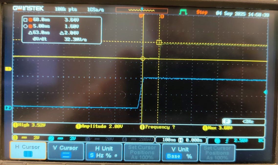

    When initiating a HW reset using reset button the voltages were:
    Without the LED ==> 0v (<20mV):
    With the LED ==> 1.6v/3.3v:
    Zoom on reset release
  • Hi Dan,
    The reserved bit (bit 11 of 0x0010) is affected by the strapping of LED_0 pin. Because LED_0 pin is 1.6V, this is causing the LED_0 pin to strap to mode 4. Thus, this enables the reserved bit to go high. We have a note in the datasheet to strap LED_0 pin in mode 1 or 3:
    Please ensure that LED_0 pin is around 0.255 x VDDIO which would be around 0.84V.
    Previously, customers have used the configuration below to achieve this:
    J
    After removing the LED, the value of register 0x10 is 0x5048. In the Linux, clearing register 0x31 resolves the issue and everything works, but we still have problems in UBoot no ping and no ARP. Do you have any suggestions for fixing this? We are using U-Boot fslc 2016, Should we consider updating to the latest version?

    There are no specific error, both ping and ARP are non functional.
    The basic network connectivity is not working on uboot.
    Here are the registers where the U-Boot value is different from the Linux value:

  • Linux:
    Uboot:
  • Hi Wesam,
    Thank you for your screenshot.
    This could be a dumb question, but is the MAC address set? It seems like you only set IP address in the screenshot you sent. Also, I checked the similar uboot screenshot that Dan posted and it looks like MAC address is never set:
    Please let me know.
    J
  • Yes, the MAC is set, it is a mechanism that reads the MAC address from an EEPROM.
    If the EEPROM is empty, a default MAC address will be used.
    If the MAC address is not set, you should see "ethaddr is not set" immediately after executing the ping command.
    The same code and U-Boot version work with the old PHY, also the same MAC address is used in the kernel.

  • The "PHY auto-negotiation FAILED" message occurs only with the new PHY.
    I attempted to write the register values you suggested, but it did not resolve the issue.
    We are not using a device tree in U-Boot; the driver initializes with default values.
    I also added some logs to the PHY driver in U-Boot and confirmed that the driver is functioning correctly.
    Today I tested U-Boot again and found that it is able to receive broadcast messages.
    Should we consider using a newer version of U-Boot? If so, can you recommend the preferred version to use?
