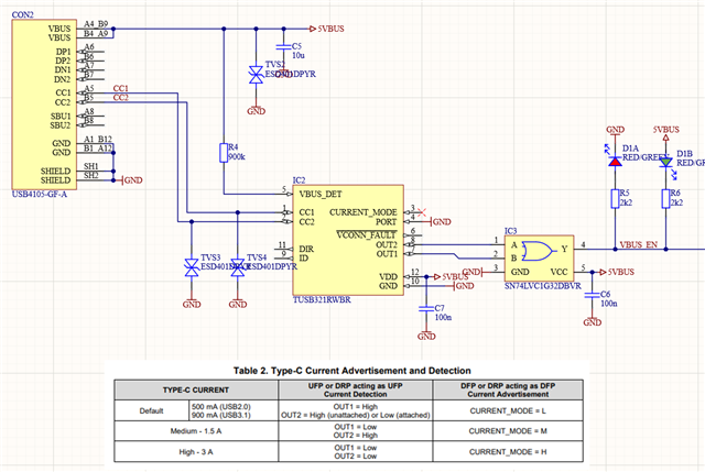

I found some issue and I don't understand what is the problem with my circuit. Or maybe with your TUSB321 device.?
Datasheet specify in UFP mode (port = GND), the OUT1 and OUT2 pin signalize the Type-C current of connected source. But this is not working. I tried various of usb sources and different cables and still the OUT1 and OUT2 is LOW.
I measured the CC voltage. Check below the result.
- When I connect USB PD charger which support 5V/3A, the voltage on CC pin was around 1.7V. -> This voltage on CC pin is correct
- I tried usbC port on my dell dock which have max output current 1.5A. The voltage on CC pin was around 0.94V. -> This voltage on CC pin is correct
- At the end I also tried standard USB-A laptop port and the voltage on CC pin was around 0.4V. -> This voltage on CC pin is correct for low current 500mA/900mA.
In all test mentioned above the OUT1/2 = LOW. This is incorrect behavior and I am looking for some advice.
Please, look at my schematic below.

  • Hi Martin,
    The OUT pins are open-drain pins. These lanes need to be pulled-up to a voltage like VDD with something like a 200KOhm resistor in order for the pin the go high, with a 200Kohm resistor being a large enough resistor to make sure the pin goes down to 0V when pulled low.
    If the pin is not pulled-up, then it will not go above 0V. At the moment, is the OUT pins low no matter whether there is a connection or not?

  • Hi Ryan,
    Thank you very much!
    I am now very angry that I overlooked it and have to modify the manufactured PCBs.
    I modified one board and it is working now.
    Thank again for your fast answer and solution.
