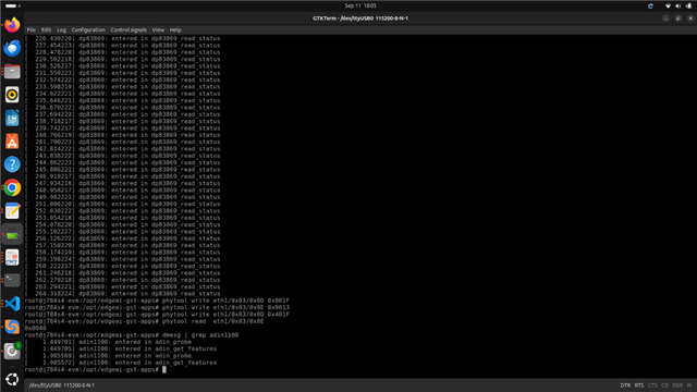

    • Checked  INTERRUPT_STATUS Register (Offset = 13h) using phytool
    • root@j784s4-evm:/opt/edgeai-gst-apps# phytool write eth1/0x03/0x0D 0x001F
    • root@j784s4-evm:/opt/edgeai-gst-apps# phytool write eth1/0x03/0x0E 0x0013
    • root@j784s4-evm:/opt/edgeai-gst-apps# phytool write eth1/0x03/0x0D 0x401F
    • root@j784s4-evm:/opt/edgeai-gst-apps# phytool read  eth1/0x03/0x0E
    • 0x0040
    •  Bit 6 set ---->MDI crossover has changed
    • Still link is down.

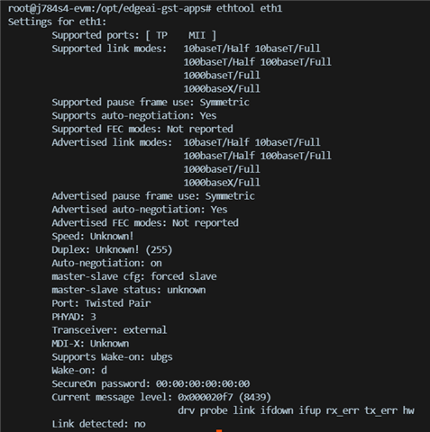

      Here are the observed outputs:
    • root@j784s4-evm:/opt/edgeai-gst-apps# dmesg | grep cpsw
    • [    1.342481] am65-cpsw-nuss 46000000.ethernet: initializing am65 cpsw nuss version 0x6BA02102, cpsw version 0x6BA82102 Ports: 2 quirks:00000000
    • [    1.355336] am65-cpsw-nuss 46000000.ethernet: initialized cpsw ale version 1.4
    • [    1.362543] am65-cpsw-nuss 46000000.ethernet: ALE Table size 64
    • [    1.372846] am65-cpsw-nuss 46000000.ethernet: CPTS ver 0x4e8a010b, freq:500000000, add_val:1 pps:1
    • [    1.461252] am65-cpsw-nuss c000000.ethernet: initializing am65 cpsw nuss version 0x6BA03102, cpsw version 0x6BA82902 Ports: 9 quirks:00000000
    • [    1.874488] am65-cpsw-nuss 46000000.ethernet: initializing am65 cpsw nuss version 0x6BA02102, cpsw version 0x6BA82102 Ports: 2 quirks:00000000
    • [    1.887349] am65-cpsw-nuss 46000000.ethernet: initialized cpsw ale version 1.4
    • [    1.894557] am65-cpsw-nuss 46000000.ethernet: ALE Table size 64
    • [    1.904882] am65-cpsw-nuss 46000000.ethernet: CPTS ver 0x4e8a010b, freq:500000000, add_val:1 pps:1
    • [    1.914914] am65-cpsw-nuss 46000000.ethernet: set new flow-id-base 48
    • [    2.001088] am65-cpsw-nuss c000000.ethernet: initializing am65 cpsw nuss version 0x6BA03102, cpsw version 0x6BA82902 Ports: 9 quirks:00000000
    • [    2.014924] am65-cpsw-nuss c000000.ethernet: Use random MAC address
    • [    2.021188] am65-cpsw-nuss c000000.ethernet: initialized cpsw ale version 1.5
    • [    2.028306] am65-cpsw-nuss c000000.ethernet: ALE Table size 512
    • [    2.034569] am65-cpsw-nuss c000000.ethernet: CPTS ver 0x4e8a010c, freq:250000000, add_val:3 pps:0
    • [    2.045877] am65-cpsw-nuss c000000.ethernet: set new flow-id-base 82
    • [    7.163522] am65-cpsw-nuss c000000.ethernet eth1: PHY [c000f00.mdio:00] driver [ADIN1100] (irq=POLL)
    • [    7.174834] am65-cpsw-nuss c000000.ethernet eth1: configuring for phy/sgmii link mode
    • root@j784s4-evm:/opt/edgeai-gst-apps# dmesg | grep dp83869
    • [    1.968261] dp83869: entered in dp83869_probe
    • [    1.968265] dp83869: entered in dp83869_of_init
    • [    1.969098] dp83869: TX internal delay not found in DT, using default: 7
    • [    1.975785] dp83869: entered in dp83869_config_init
    • [    1.975996] dp83869: entered in dp83869_configure_mode
    • [    1.977030] dp83869: mode=3 entered RGMII_SGMII_BRIDGE in dp83869_configure_mode
    • [    1.978681] dp83869: entered in dp83869_config_port_mirroring
    • [    1.979509] dp83869: entered in dp83869_config_intr
    • [    1.979718] dp83869: entered in dp83869_ack_interrupt
    • root@j784s4-evm:/opt/edgeai-gst-apps# dmesg | grep adin1100
    • [    1.980934] adin1100: entered in adin_probe
    • [    1.980938] adin1100: entered in adin_get_features
    • [    7.141021] adin1100: entered in adin_soft_reset
    • [    7.160799] adin1100: entered in adin_resume
    • [    7.160811] adin1100: entered in adin_set_powerdown_mode
    • [    7.187903] adin1100: entered in adin_resume
    • [    7.187910] adin1100: entered in adin_set_powerdown_mode
    • [    7.190617] adin1100: entered in adin_config_aneg
    • [    7.205395] adin1100: entered in adin_read_status
    • [    8.227916] adin1100: entered in adin_read_status
    • [    9.251914] adin1100: entered in adin_read_status
    • [   10.275913] adin1100: entered in adin_read_status
    • [   60.606602] adin1100: entered in adin_get_sqi
    • [   60.607443] adin1100: entered in adin_get_sqi_max
    • [   61.471910] adin1100: entered in adin_read_status
    • [   62.495909] adin1100: entered in adin_read_status
    • [   63.519904] adin1100: entered in adin_read_status
    • [   64.543909] adin1100: entered in adin_read_status
    • [   65.567908] adin1100: entered in adin_read_status
    • [   66.591908] adin1100: entered in adin_read_status

    Below is the information  i got from datasheet regarding setting dp83869 as SGMII to RGMII bridge:
    In SGMII-to-RGMII mode, Ethernet MAC is connected to the SGMII pins of the DP83869HM and PHY is
    connected to the RGMII pins of the DP83869. In this mode, DP83869HM configures SGMII in Auto. In Auto
    mode, SGMII adapts the link speed based on RGMII.
    After auto-negotiation is completed on the PHY side, the link capabilities are communicated to DP83869HM over
    the RGMII interface. However, this information needs to be conveyed to the Ethernet MAC as well. The MAC can
    read this information from the DP83869HM through the registers.
    In SGMII-to-RGMII Bridge mode, the DP83869 acts as RGMII MAC for the Ethernet PHY. The DP83869 RX pins
    acts as output pins from the DP83869 to the Ethernet PHY TX pins, and the DP83869 TX pins acts as input pins
    for the Ethernet PHY RX pins.
    My question is in dts setup under cpsw_port0 what to define under phy-handle and phy-mode?
    Since dp83869hm acts as bridge and adin1100 is the ethernet phy do i need to define adin1100 and rgmii under phy-handle and phy-mode?
    Does Linux CPSW need to bind directly to the ADIN1100’s MDIO node (with DP83869 only acting as a hardware bridge)?
    B.Apuroop Kumar
