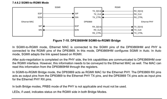

    In our setup we need the DP83869HM to operate in SGMII-to-RGMII bridge mode.The Linux driver’s ti,op-mode = <DP83869_RGMII_SGMII_BRIDGE> appears to program the opposite direction (RGMII-to-SGMII), so I removed ti,op-mode.
    From the datasheet, I see that the bridge can be set through strap pins (e.g. MIRROR_EN). I want to confirm , is it possible to configure this bridge direction through registers as well, or is it only strap-configurable
    B. Apuroop Kumar
    Let me forward this to the phy team and see if any more changes are required for this.
    Tanmay
  • Hi Apuroop,
    RGMII-SGMII bridge is programmable via register configuration as well.
    Please follow the below screenshot:
    But, instead of writing 0x0043 to register 1DFh, please write the following:
    Write 0x0003 to register 1DFh.
    J
    I modified the driver to write 0x0003 to register 1DFh instead of 0x0043.Below is the output:

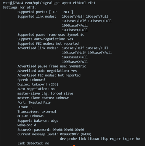

    but the link is not coming up.
    ethtool eth1 shows "Link detected: no" and speed/duplex are unknown.
    root@j784s4-evm:~# ethtool eth1
    Settings for eth1:
    Supported ports: [ TP MII ]
    Supported link modes: 10baseT/Half 10baseT/Full
    100baseT/Half 100baseT/Full
    1000baseT/Full
    1000baseX/Full
    Supported pause frame use: Symmetric
    Supports auto-negotiation: Yes
    Supported FEC modes: Not reported
    Advertised link modes: 10baseT/Half 10baseT/Full
    1000baseT/Full
    1000baseX/Full
    Advertised pause frame use: Symmetric
    Advertised auto-negotiation: Yes
    Advertised FEC modes: Not reported
    Speed: Unknown!
    Duplex: Unknown! (255)
    Auto-negotiation: on
    master-slave cfg: forced slave
    master-slave status: unknown
    Port: Twisted Pair
    PHYAD: 3
    Transceiver: external
    MDI-X: Unknown
    Supports Wake-on: ubgs
    Wake-on: d
    SecureOn password: 00:00:00:00:00:00
    Current message level: 0x000020f7 (8439)
    drv probe link ifdown ifup rx_err tx_err hw
    Link detected: no

    What additional configuration might be needed for SGMII-RGMII bridge mode?
    B.Apuroop Kumar
  • Hi Apuroop,
    Aforementioned register configuration is all you need.

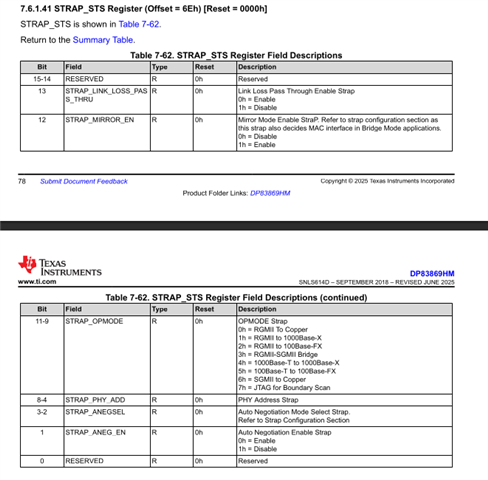

    Could you check register 01h to see what the value is? Because the PHY is in bridge mode, we don't expect the PHY to report speed and duplex information necessarily.
    J
    The CPSW MAC is configured in SGMII mode
    DP83869(connected to mdio bus at address3) is set to SGMII to RGMII bridge mode
    ADIN1100(connected to same mdio bus at address0) is the  PHY connected to the line.
    In Linux, I modified DP83869 driver (dp83869.c) configuring the device into bridge mode, but the MAC is still treating DP83869 as the PHY.
    What I would like is for DP83869 to act as a  bridge and for the Linux PHY framework to use ADIN1100 as the true PHY (with DP83869 just converting SGMII<-->RGMII)

    From my understanding, the DP83869 is still reporting standard 10/100/1G copper capabilities, while the ADIN1100 only advertises 10 Mb full duplex (as expected for 10BASE-T1L).
    In SGMII–RGMII bridge mode, should the DP83869’s BMSR still reflect its legacy copper capabilities, or should it transparently pass through the downstream PHY’s (ADIN1100) status?
    Since both PHYs report link down, what is the correct expectation for the DP83869’s register 0x01 when bridging to a 10BASE-T1L PHY like ADIN1100?
    Does Linux CPSW need to bind directly to the ADIN1100’s MDIO node (with DP83869 only acting as a hardware bridge), or is the driver expected to interpret the DP83869’s BMSR instead?
    This will help me understand if I should adjust the device tree / driver setup to ensure CPSW is monitoring the true PHY (ADIN1100) rather than the bridge.
    Apuroop
  • Hi Apuroop,
    DP83869 BMSR reflects its legacy copper capabilities.
    DP83869 register is expected to report link down since register 0x01 reflects MDI link of DP83869, but DP83869 is in bridge mode so there is expected to be no link. Please inquire separately on ADIN1100 why the link status is down on this because the link status is usually determined by the cable connection.
    Linux CPSW needs to bind directly to the ADIN1100 MDIO node.
    Because DP83869 is just acting as a bridge, there is no need to monitor the bridge as a separate PHY node.
    I am inquiring the relevant team on how the bridge should be set up in Linux CPSW so I will update you once we get this information.

    [ 7.334861] am65-cpsw-nuss c000000.ethernet eth1: PHY [c000f00.mdio:00] driver [ADIN1100] (irq=POLL)
    [ 7.346502] am65-cpsw-nuss c000000.ethernet eth1: configuring for phy/sgmii link mode
    root@j784s4-evm:/opt/edgeai-gst-apps#
    Settings for eth1:
    Supported link modes: 10baseT1L/Full
    Advertised link modes: 10baseT1L/Full
    Speed: Unknown!
    master-slave cfg: preferred slave
    Port: Twisted Pair
    PHYAD: 0
    MDI-X: Unknown
    Supports Wake-on: d
    Wake-on: d
    Link detected: no
    SQI: 0/7

    root@j784s4-evm:/opt/edgeai-gst-apps# dmesg | grep Reading
    [ 1.427343] Reading DP83869_STRAP_STS1 register = 630
    [ 1.995397] Reading DP83869_STRAP_STS1 register = 630

    Eventhough i replaced phy-handle to point adin1100, link is not up.
    B. Apuroop Kumar.
  • Hi Apuroop,
    We may have to tune the RGMII delay on both ADIN1100 and DP83869 to get the link up now.
    Could you see if controlling the value on 0x32 helps on DP83869?
    Also, if you read the 0x01 register on ADIN1100, do you see that the link is up?

  • Hi Apuroop,
    This is ADIN1100 issue since the link should be up on the ADIN1100 PHY. The link may not be up on Linux but ADIN1100 is expected to be up when there is cable connected to ADIN1100.
    Please let me know if the issue persists once you figure out the link loss issue with ADIN1100.
    J

    root@j784s4-evm:/opt/edgeai-gst-apps# ifconfig
    eth1: flags=4099<UP,BROADCAST,MULTICAST>  mtu 1500
            ether ba:89:36:c7:7b:c4  txqueuelen 1000  (Ethernet)
            RX packets 0  bytes 0 (0.0 B)
            RX errors 0  dropped 0  overruns 0  frame 0
            TX packets 0  bytes 0 (0.0 B)
            TX errors 0  dropped 0 overruns 0  carrier 0  collisions 0
    lo: flags=73<UP,LOOPBACK,RUNNING>  mtu 65536
            inet 127.0.0.1  netmask 255.0.0.0
            inet6 ::1  prefixlen 128  scopeid 0x10<host>
            loop  txqueuelen 1000  (Local Loopback)
            RX packets 92  bytes 7654 (7.4 KiB)
            TX packets 92  bytes 7654 (7.4 KiB)
    root@j784s4-evm:/opt/edgeai-gst-apps# ethtool eth1
    Settings for eth1:
                              1000baseT/Full
                              1000baseX/Full
                              1000baseT/Full
                              1000baseX/Full
      Speed: Unknown!
      Port: Twisted Pair
      PHYAD: 3
      MDI-X: Unknown
      Wake-on: d
      Link detected: no
    root@j784s4-evm:/opt/edgeai-gst-apps#ip a
    3: eth1: <NO-CARRIER,BROADCAST,MULTICAST,UP> mtu 1500 qdisc mq state DOWN group default qlen 1000
    link/ether ba:89:36:c7:7b:c4 brd ff:ff:ff:ff:ff:ff
    root@j784s4-evm:/opt/edgeai-gst-apps# phytool read eth1/0x00/0x01
    0x796d
    The status register of adin1300 indicates link is up and auto  negotiation is completed. Still ethernet is not working.
    B. Apuroop Kumar

  • Also I want to mention about the changes i made to dp83869 driver code.
    In the existing driver,
    /* STRAP_STS1 bits */
    #define DP83869_STRAP_OP_MODE_MASK		GENMASK(2, 0)
    static int dp83869_set_strapped_mode(struct phy_device *phydev)
    	struct dp83869_private *dp83869 = phydev->priv;
    	int val;
    	val = phy_read_mmd(phydev, DP83869_DEVADDR, DP83869_STRAP_STS1);
    	if (val < 0)
    		return val;
    	dp83869->mode = val & DP83869_STRAP_OP_MODE_MASK;
    	return 0;
    But as per the datasheet , the strap_opmode bits are [11:9]
    So I modified the driver like below:
    #define DP83869_STRAP_OP_MODE_MASK GENMASK(11, 9)
    #define DP83869_STRAP_OP_MODE_SHIFT 9
    printk(KERN_DEBUG "dp83869: entered in %s\n", __func__);
    int val;
    if (val < 0)
    return val;
    printk(KERN_DEBUG "Reading DP83869_STRAP_STS1 register = %x\n", val);
    dp83869->mode = (val & DP83869_STRAP_OP_MODE_MASK) >> DP83869_STRAP_OP_MODE_SHIFT ;
    printk(KERN_DEBUG "dp83869: Hardware strapped mode = %d\n", dp83869->mode);
    return 0;
    With the above changes , now using strap pin configurations, it is going to proper op_mode

  • Hi Apuroop,
    STRAP_STS register is not a writeable register. If you are changing opmode or other strap configuration via register, you will have to write on the register that strap status register impacts directly instead of changing the strap status register.
    J
  • Hi J,
    But I am not writing to the STRAP_STS register. I am changing the mask from GENMASK(2,0) to GENMASK(11,9) since the bit positions of STRAP_OPMODE are [11:9] as per the datasheet. The existing driver code was incorrectly reading bits [2:0] instead of bits [11:9], which caused it to always report mode = 0 even though the hardware was strapped to mode 3 (SGMII-to-RGMII bridge).
    My change only affects how the driver interprets the read value - no hardware registers are being written.
    B. Apuroop kumar
  • Hi Apuroop,
    I see. That makes sense. With this change, is there any improvement?

    Just wanted to let you know what modifications I did to configure  dp83869hm in sgmii to rgmii bridge. But there is no improvement. Can you suggest how to define  delays when operating in sgmii to rgmii bridge mode?
    B. Apuroop kumar.
  • Hi Apuroop,
    Sounds good. You can use register 32h to change the delay on RGMII line. Please refer to the datasheet for more detail, but it is configurable from 0ns to 4ns and the default is 2ns delay.
    J
