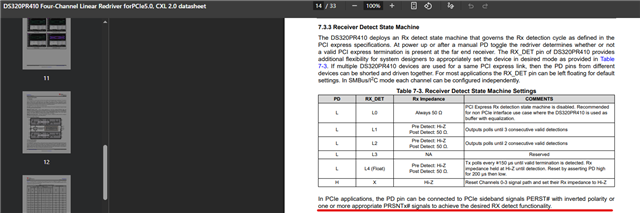

We use SN75LVPE5412&SN75LVPE5421 to design a Gen5 PCIe X4  AIC for MCIO 38P.
Unlike DS320PR410, there is no similar description in SN75LVPE5412 datasheet. What's the recommended connection of  PD pin  if  we use SN75LVPE5412&SN75LVPE5421? Thank you.

    See our E2E FAQ for advice on how to configure the PD pin:  [FAQ] DS320PR810: How should PCIe redriver PD pins be configured?

  • Hi Ian,
    I would recommend connecting PD to inverted PERST# based on experience. However the PERST# signal is generated by the root complex (probably CPU in this case), so I am not sure what is meant by "on the M.2 side". The M.2 SSD should have a PERST# input to participate in the PCIe link but the signal should pass through the adapter card (where the redriver is) before it gets to the SSD.
