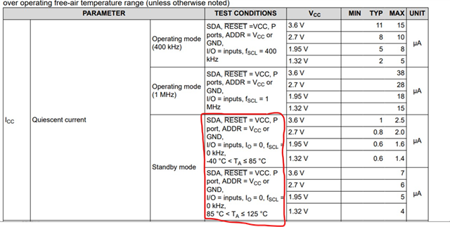

May I confirm is it correct if fSCL = 0 kHz will let the device enter standby mode ?

But the datasheet do mentioned standby spec as below, would you help comfirm what it is ? and how to enter that mode ?
Hi PYTsai,
This is different from standby mode in SMBus.
This standby mode is the current when the conditions in red are met. Not when SCL is held LOW for a period of time.
For standby mode current to be measured,
SCL & SDA & /RESET = VCC through a PU resistor
P-port & ADDR = VCC or GND,
I/O's = INPUTS
IO = 0 mA
fSCL = 0 kHz (meaning clock is idle HIGH, not toggling at any frequency)
