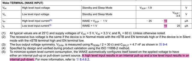

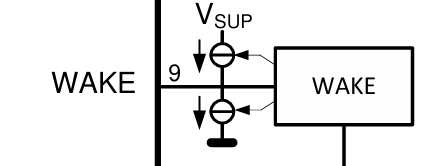

It's said in Datasheet that "the WAKE automatically configures itself based on the applied voltage to have either an internal pull-up or pull-down current source.".
  • How does "automotically configures" work? Does it means if V_wake > VSUP - 1.9( high level input), WAKE block turns on the internal pull-up current source, and vice versa?
  • How quickly does the WAKE module detect the input voltage and turn on the current source?
    Effectively, yes.
    What is your goal with understanding how this Wake pin functions? Does the customer intend to switch from high to low level wake signals while the device is powered and operational?
    In application, only one particular configuration should be used. For example, the Wake pin should be biased to VSUP only, such that a low level voltage signal (i.e. GND) wakes the device. We do not provide the time it takes to detect the input voltage and use the appropriate current source.

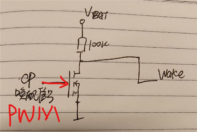

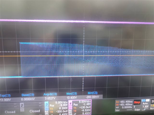

    In my customer's application, the WAKE signal is 1K PWM, which looks like below. I want to understand how this Wake pin functions to explain why the voltage drops down a little.
    And it's baised to VSUP to 100K,directly connect to WAKE pin without R_series as below.

    I think this issue didn't show up because the PWM wake signal may drop as you can see in the first picture. And TCAN1043 will not be waken if it drop enough to below VSUP - 1.9. This may be in a relatively critical state.

    1. Does the PWM signal drop down because the 100K pull up resistor is too big, which is required as  to keep the valid V_IH?

  • Hi Wonder,
    The Wake pin was not designed for a PWM signal. We strongly do not recommend using a PWM here. Even if this did properly wake the device, my main concern is that the Wake pin will constantly read a local wake up source preventing TCAN1043 from switching into particular modes on the state machine. For instance, if the PWM stays active while the transceiver is powered on, it will never be able to enter Sleep mode from Go-to-Sleep mode.
