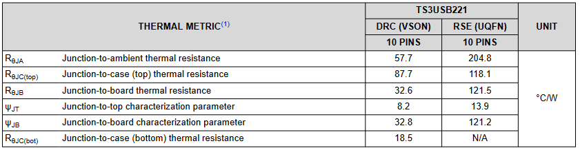

Could you help check and provide the max working junction temperature of TS3USB221RSER?

Our camera products are designed for outdoor environments with high temperatures. We are currently trying to choose devices with TJ temperatures above 115 degrees or TA temperatures above 105 degrees. Therefore, let's first check if your company's TS3USB221RSER TJ has reached temperatures above 115 degrees.

Thanks so much for the clarification! I calculated the Tj by using the instructions and calculator template on this FAQ. Assuming the customer will not be using the switch in low power mode, the Tj for the RSE package is 120.4C.

Based on datasheet, I didn't see the Tj for TS3USB221, could you help further comment does the 120.4C OK for our part TS3USB221?
Will
Hi Will,
As Katy mentioned, she got the value from the calculator in this FAQ:
(+) [FAQ] How to Calculate the Max Junction Temperature of an Analog Switch/Multiplexer. - Switches & multiplexers forum - Switches & multiplexers - TI E2E support forums
It is not from the datasheet
So yea, the 120.4C is okay for TS3USB221RSER
