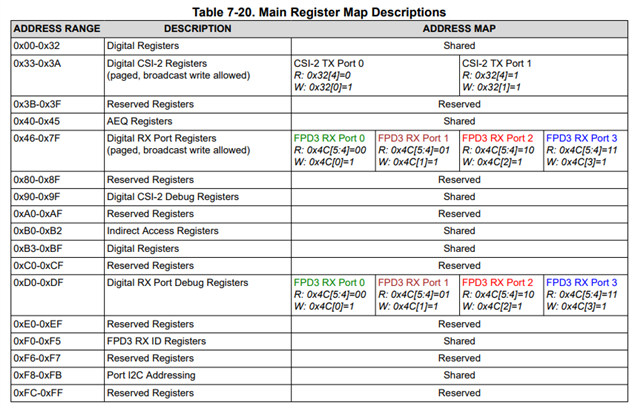

  • Hi Tuan,
    The DS90UB960 is capable of aggregating four video streams into a single CSI-2 port. To ensure the input bandwidth does not exceed the total output bandwidth, we have the following resource available to go over aggregation scenarios. The following video from the FPD-Link Training Center will cover this behavior: https://www.ti.com/video/6247583604001
    The linked E2E thread will also provide a calculator and general explanation of how to use the tool: https://e2e.ti.com/support/interface-group/interface/f/interface-forum/1132331/ds90ub960-q1-csi2-aggregation-bandwidth-calculator?tisearch=e2e-sitesearch&keymatch=aggregation%2520AND%2520ds90ub960#
    VC-ID is recommended to be remapped prior to enabling forwarding. VC-ID remapping is done on a per RX port basis by configuring register 0x72.
    An example configuration can be seen as follows:
    # "*** RX0 VC=0 ***"
    WriteI2C(0x4C,0x01) # RX0
    WriteI2C(0x72,0xE4) # RX0 VC
    # "*** RX1 VC=1 ***"
    WriteI2C(0x4C,0x12) # RX1
    WriteI2C(0x72,0xE4) # RX1 VC
    # "*** RX2 VC=2 ***"
    WriteI2C(0x4C,0x24) # RX2
    WriteI2C(0x72,0x9F) # RX2 VC
    # "*** RX3 VC=3 ***"
    WriteI2C(0x4C,0x38) # RX3
    WriteI2C(0x72,0xDF) # RX3 VC
    # "CSI_TX_SPEED"
    WriteI2C(0x1F,0x00) # CSI rate select
    # "CSI_PORT_SEL"
    WriteI2C(0x32,0x01) # CSI0 select
    # "CSI_EN"
    WriteI2C(0x33,0x01) # CSI_EN & CSI0 4L
    # "***Basic_FWD"
    WriteI2C(0x21,0x14) # Synchronized Basic_FWD
    # "***FWD_PORT all RX to CSI0"
    WriteI2C(0x20,0x00) # forwarding of all RX to CSI0
    Registers 0x72 , 0x1F-0x21, and 0x33 should be adjusted based on the desired system level behavior. By default 0x72 is set so that the original VC-ID that passes through the link is maintained.

    Initialize the DS90UB960 and configure the I²C alias addresses.
    Please refer to lines 46-59 of the attached script for reference.
    Initialize the DS90UB953 serializer.
    Please refer to lines 78-92. In this script, it is assumed the UB953 is strapped to CSI synchronous mode and the imager outputs over 4 lanes with a non-continuous clock. To change this setting write to register 0x02 on the serializer.
    These configurations on the UB953 are primarily related to the image sensor bring up process, this is not specific to the serializer operation.
    Forward the CSI data from the camera through the serializer/deserializer to the SoC.
    Please see below from prior response for convenience:
    # "CSI_TX_SPEED"
    # "CSI_PORT_SEL"
    # "CSI_EN"
    # "***Basic_FWD"

  • Hi Tuan,
    I am not familiar with the linux errors shared here. For debugging the SerDes I suggest reading back the following registers:
    1. On the UB960
      1. Select port used in 0x4C
      2. Read back 0x4D, 0x4E, 0x55, 0x56, 0x7A, 0x7B to clear
      3. Wait for run time
      4. Read back registers listed in step B once more
    2. On the UB953
      1. Read back 0x5C-0x60 to clear
      2. Wait for run time
      3. Read back registers 0x5C-0x60 once more
    Error registers should be read back to clear from the initialization sequence. If already completed, the error status registers can then be pulled directly.
    Secondly, please ensure the CSI transmitter is set to the correct settings as expected by the SoC in register 0x33 of the DS90UB960. The serializer should also be set for the correct number of CSI input lanes in 0x02.
    Zoe
