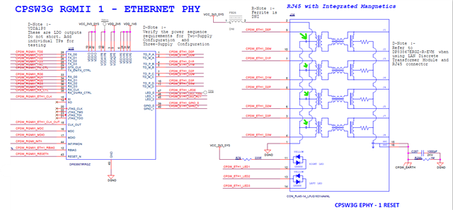

Hi Team,
In below thread, it is recommended not to use the part with all center taps shorted.
DP83867IR: DP83867IR RJ45 connector with integrated magnetics - Interface forum - Interface - TI E2E support forums
But, center taps are shorted in TMDS64EVM. Could you please clarify?
