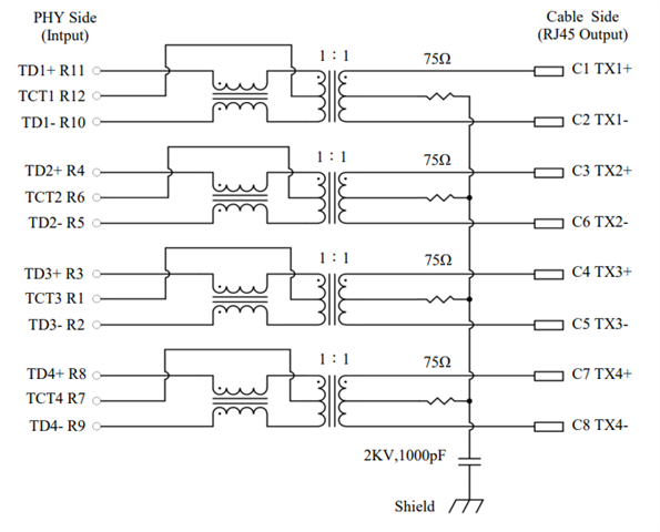

My customer is considering using the RJ45 connector at the following URL in combination with the DP83867IS.
・UDE RH1-ZZ-0033
https://www.ude-corp.com/archive/product/item/Datasheet/RH1-ZZ-0033.pdf
・UDE RH1-ZZ-0060
https://www.ude-corp.com/archive/product/item/Datasheet/RH1-ZZ-0060.pdf
Based on previous posts, I understand that the center tap of the transformer channel in this RJ45 is shorted, which is not recommended for achieving optimal EMI performance.
However, the customer has already started drafting the schematic and is short on time. While it may be difficult to achieve sufficient EMI performance, is it correct to assume that there will be no issues with basic operation?
If you have any other recommended RJ45 connectors with integrated transformers, please let me know the model numbers.
Kyohei
  • Hi Kyohei-san,
    Both magnetics are within our recommended specifications.
    You are correct that we do not recommend CT shorted transformer for optimal EMI performance but the basic operation most likely will not have issue unless there are other issues that may affect the DGND/EGND.
    For other recommendations, our datasheet typically recommend Pulse HX5008NL.
