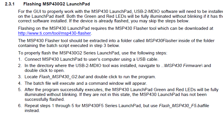

  • Hi Shane ,
    First, does MSP430F5 series require to flash MSP430 ?
    Section 2.3.1 Flashing MSP430 is for G2 series.
    Could you also walk through how to flash MSP430 Launchpad in order to access MDIO ?
    Following procedure below the section 2.3.1.

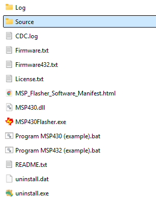

    // Extracted MSP430 Flasher under C/ti/MSPFlasher_1.3.20 folder shown below.
    // Installed the Flasher in Windows; however, no app. appears in search window to open up the MSP430 Flasher GUI.
    // Below is downloaded and extracted USB-2-MDIO tool; however, there is no directory called .\MSP430 Firmware under USB-2-MDIO tool folder.
  • Hi James,
    Yes MSP430F5 requires flashing for USB2MDIO. One way to flash the MSP430 is using Uniflash with the flash image file below:
    2437.msp430-usb-to-mdio-universal-v3.04.txt
    Here is a guide for bringing up USB2MDIO with uniflash: 5141.How to flash MSP430 Launchpad for USB2MDIO compatibility.pptx
    Let me know if you run into any issues while following this guide.
