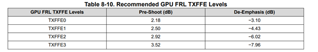

    The Link Training Compatible Rx EQ mode is recommended in source application. Below is the TXFFE levels that this mode assumes the GPU is using. Can this requirement be supported by your source?
    In your case, which you are trying to have adaptive equalization at the RX input to different channel/cable loss, this is more a sink application. In which case, you would want to use the TMDS1204  Adaptive EQ (AEQ) feature and put the TDP1204 into linear re-driver.
    Please correct me if my understanding is not correct.
    David

    The TMDS1204 will perform adaptive equalization when FRL link training begins. It will also re-adapt each time the data rate changes. The adaption will only occur during the TXFFE0 portion of FRL link training when LTP5, LTP6, LTP7, or LTP8 is being received. So for the Bert, you will want it to output one of the LTP link training pattern.
    Also the AEQ is only supported in HDMI2.1 mode. So you want to make sure the register 0x31 is set to the "Not 0h".
    The time from start of FRL link training to AEQ complete for 6Gbps, 8Gbps, 10Gbps, and 12Gbps is max of 0.5ms. You can also poll AEQ_STATUS Register (Offset = 50h) bit 7 to make sure AEQ is completed.
    David

    Is HPD_IN high or low in this particular case?
    With register 0x0A set to 0x07, RATE snoop is disabled. You should able to write to register 0x20h or 0x31h.
    Are you able to write 0x02 to register 0x20h or 0x06 to register 0x31?
    If register 0x31 is 0x00, then TMDS1204 is not in FRL mode and AEQ will not start.
    David
  • I believe HPD_IN is low since we're relying on HPD_PWRDWN_DISABLE and STANDBY_DISABLE bits to bring the TMDS1204EVM out of standby and allow signal flow through to the Scope from BERT. Let me try modifying 0x20h and 0x31h with those values.
    Does the above chart have any relevance to our situation?
    With EN high and HPD_PWRDWN_DISABLE/STANDBY_DISABLE bits being set to 1, TMDS1204 should be in active mode as circled below.
    With RATE_SNOOP_CTRL bit set to 1 to disable DDC snooping, you should able to write to register 0x20 or 0x31 to configure TMDS1204 either in HDMI1.4 (both 0x20 and 0x31 == 0x00), HDMI2.0 (0x20 = 0x02 and 0x31 = 0x00), or HDMI2.1 (0x20 = 0x00 and 0x31 = non-zero value).
    David
