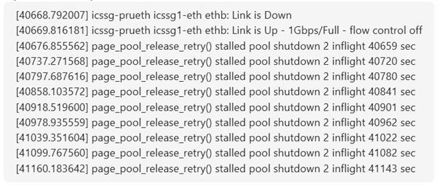

DP83869HM: AM6442BSDGHAALV to DP83869HM
Part Number: DP83869HM
Other Parts Discussed in Thread: DP83869, AM6442
                ethernetA = &cpsw_port1;
                ethernetB = &icssg1_emac1;
                ethernetC = &icssg1_emac0;
                ethernetD = &icssg0_emac1;
                ethernetE = &icssg0_emac0;

        icssg1_eth: icssg1-eth {
                status = "okay";
                compatible = "ti,am642-icssg-prueth";
                pinctrl-names = "default";
                pinctrl-0 = <&icssg1_rgmii1_pins_default>, <&icssg1_rgmii2_pins_default>;
                sram = <&oc_sram>;
                ti,prus = <&pru1_0>, <&rtu1_0>, <&tx_pru1_0>, <&pru1_1>, <&rtu1_1>, <&tx_pru1_1>;
                ti,iep = <&icssg1_iep0>, <&icssg1_iep1>;
                firmware-name = "ti-pruss/am64x-sr2-pru0-prueth-fw.elf",
                                "ti-pruss/am64x-sr2-rtu0-prueth-fw.elf",
                                "ti-pruss/am64x-sr2-txpru0-prueth-fw.elf",
                                "ti-pruss/am64x-sr2-pru1-prueth-fw.elf",
                                "ti-pruss/am64x-sr2-rtu1-prueth-fw.elf",
                                "ti-pruss/am64x-sr2-txpru1-prueth-fw.elf";
                ti,pruss-gp-mux-sel = <2>,      /* MII mode */
                                      <2>,
                                      <2>,
                                      <2>,      /* MII mode */
                                      <2>,
                                      <2>;
                ti,mii-g-rt = <&icssg1_mii_g_rt>;
                ti,mii-rt = <&icssg1_mii_rt>;
                ti,pa-stats = <&icssg1_pa_stats>;
                interrupt-parent = <&icssg1_intc>;
                interrupts = <24 0 2>, <25 1 3>;
                interrupt-names = "tx_ts0", "tx_ts1";
                dmas = <&main_pktdma 0xc200 15>, /* egress slice 0 */
                       <&main_pktdma 0xc201 15>, /* egress slice 0 */
                       <&main_pktdma 0xc202 15>, /* egress slice 0 */
                       <&main_pktdma 0xc203 15>, /* egress slice 0 */
                       <&main_pktdma 0xc204 15>, /* egress slice 1 */
                       <&main_pktdma 0xc205 15>, /* egress slice 1 */
                       <&main_pktdma 0xc206 15>, /* egress slice 1 */
                       <&main_pktdma 0xc207 15>, /* egress slice 1 */
                       <&main_pktdma 0x4200 15>, /* ingress slice 0 */
                       <&main_pktdma 0x4201 15>, /* ingress slice 1 */
                       <&main_pktdma 0x4202 0>, /* mgmnt rsp slice 0 */
                       <&main_pktdma 0x4203 0>; /* mgmnt rsp slice 1 */
                dma-names = "tx0-0", "tx0-1", "tx0-2", "tx0-3",
                            "tx1-0", "tx1-1", "tx1-2", "tx1-3",
                            "rx0", "rx1",
                            "rxmgm0", "rxmgm1";
                ethernet-ports {
                        #address-cells = <1>;
                        #size-cells = <0>;
                        status = "okay";
                        icssg1_emac0: port@0 { /* ETH-C */
                                status = "okay";
                                reg = <0>;
                                phy-handle = <&icssg1_phy1>;
                                phy-mode = "rgmii-id";
                                ti,syscon-rgmii-delay = <&main_conf 0x4108>;
                                /* Filled in by bootloader */
                                local-mac-address = [1C 63 49 1A DE 17];
                        icssg1_emac1: port@1 { /* ETH-B */
                                status = "okay";
                                reg = <1>;
                                phy-handle = <&icssg1_phy2>;
                                ti,syscon-rgmii-delay = <&main_conf 0x410c>;
                                local-mac-address = [1C 63 49 1A DE 18];

&icssg0_mdio {
        status = "okay";
        pinctrl-0 = <&icssg0_mdio1_pins_default>;
        icssg0_phy1: ethernet-phy@f {
                reg = <0xf>;
                ti,rx-internal-delay = <DP83867_RGMIIDCTL_2_00_NS>;
                ti,fifo-depth = <DP83867_PHYCR_FIFO_DEPTH_4_B_NIB>;
        icssg0_phy2: ethernet-phy@3 {
                reg = <0x3>;
&icssg1_mdio {
        status = "okay";
        pinctrl-0 = <&icssg1_mdio1_pins_default>;
        icssg1_phy1: ethernet-phy@f {
                reg = <0xf>;
        icssg1_phy2: ethernet-phy@3 {
                reg = <0x3>;

Note: We are facing the Link Instability issue (i,e.: Link Down / Link Up) in ICSSG0 & ICSSG1 Core only.
Can you please help us to proceed further.

    Also how are you determining intermittent link drop?
    Ans: We are determining it through the Debug log; there we are able to see that Eth-B Link Down & Link Up very frequently & Eth-C, D & E Link Down & Up occasionally.
    Is Reg 0x1 or LED0 of the device showing such behavior?
    Ans: We did not observe the Reg 0x1 or LED0, but we are confirming the Link Down and Link as per the Debug log. Below is the Debug log for your reference.

    During the Link Down report and when we read the Register 0x1 the value is 0x796d, and after the particular port Link Up report also the Register 0x1 is 0x796d only.
    So, this shows that the Reg 0x1 bit-2 is always High (1) even when the Link down report has occurred. Which indicates the Link status is Up.
    Amarnath G
    This indicates that SoC is reporting a false link down event. It is recommended to check in with SoC to understand why this is happening. The PHY is performing as expected.

  • Hi Gerome/Johnson,
    When we moved the Eth-B from ICSSG core to the CPSW Core we did not encounter any Ethernet Intermittent link status. But when the Eth-B is connected to the ICSSG0 we encounter the Ethernet Intermittent link status.
    Can we please get some update on the above issue?

    Ethernet packet loss
    Please attach the terminal commands you are using to test. Please also include ethtool -S.
    Ans: We are performing the Ethernet Packet Loss through third part network testing tool iperf3. Below are the iperf3 Commands used for testing.
             To run as Server: iperf3 -s -B 10.10.1.100 -i 1 (10.10.1.100 is the Static IP set to Ethernet Port, Here Server is our Custom Board with AM64xx).
             To run as Client: iperf3 -c 10.10.1.100 -u -B 10.10.1.1 -b 5M -t 61200 -i 1 (Here Client is Windows PC).

    Note: The Ethtool statistic has been captured when there is no packet loss, Since the test is ongoing and kept for 24 hours, we shall send you the updated statistics once the ongoing test is completed.
    Thank you.
