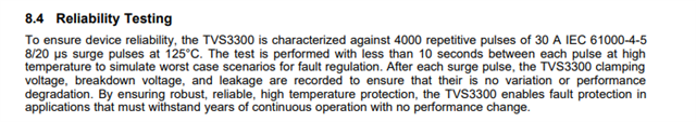

I am currently using the TVS3300 in one of our projects. Based on the transient analysis simulation, the peak power dissipation is estimated to be 20.5W [TD = 450ns].
Could you please confirm whether the TVS3300 can reliably withstand 5000 consecutive pulses, spaced 200ms apart?
