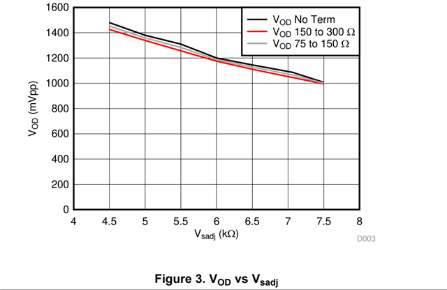

My customer is currently conducting HDMI 1.4 compliance test and some of the test items are showing Fail. Can you help me to clear this issue?
Attached is the result report.
■ID7-2
Is improvement expected by changing the following items in the register settings?
VSWING_DATA: Data output swing control
VSWING_CLK: Clock Output Swing Control
■HF1-4
Although no effective countermeasures have been found at this time, the wiring lengths between the connector devices are as follows:
Could you please advise on what might be causing the problem?

    For the intra-pair skew failure on the CLK, do you have a common mode choke on it?
    For VL failure, please tune the VSADJ resistor first. The VSDAJ tune both the VOD (Swing) and VL. As shown below, the lower VSADJ, the higher VOD but lower VL. The higher VSADJ, the lower VOD but higher VL. The goal is to find a VSADJ resistor value that can satisfy both the VOD and VL requirement.
    On top of the VSADJ, you can further fine tune it using register 0x0C.
