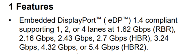

    The DSI86 is a DSI to eDP/DP bridge. The video bandwidth that can be transmitted depends on both the input and output interfaces.
    For the DSI input, it can support up to 750 MHz clock frequency and 1.5 Gbps per lane. Over 8 lanes, dual DSI ports, it can support a maximum of 12 Gbps video input.
    The DP output video can support 1, 2 or 4 lanes at different lane rates as mentioned on the front page.
    1. For the full video bandwidth, it would help if you shared the pixel clock rate of the 4K video, since the blanking can vary.
    Assuming, that the pixel clock rate = Htotal * Vtotal * fps = 4400 pixels * 2250 lines * 30 fps = 297 MHz.
    Then the video bandwidth = PCLK * bpp - 297 MHz * 18 bpp = 5.346 Gbps
    This can be supported with 4 lanes because each data lane can support up to 1.5 Gbps.
