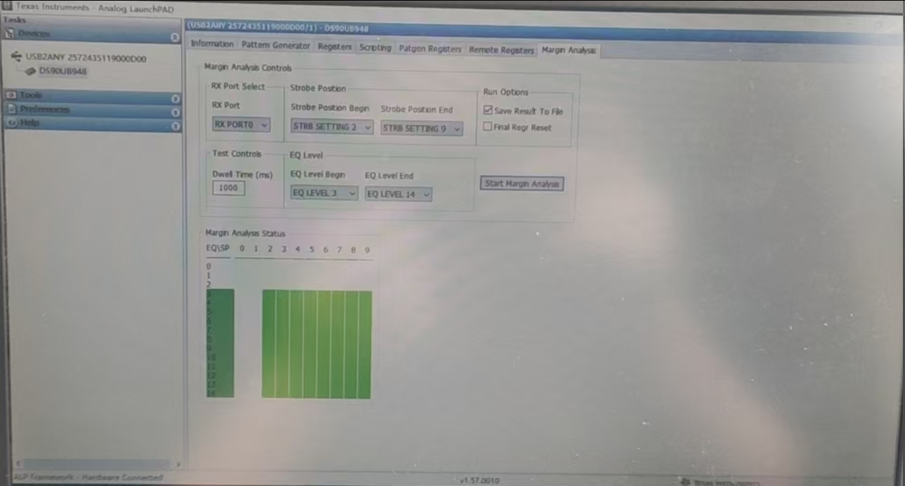

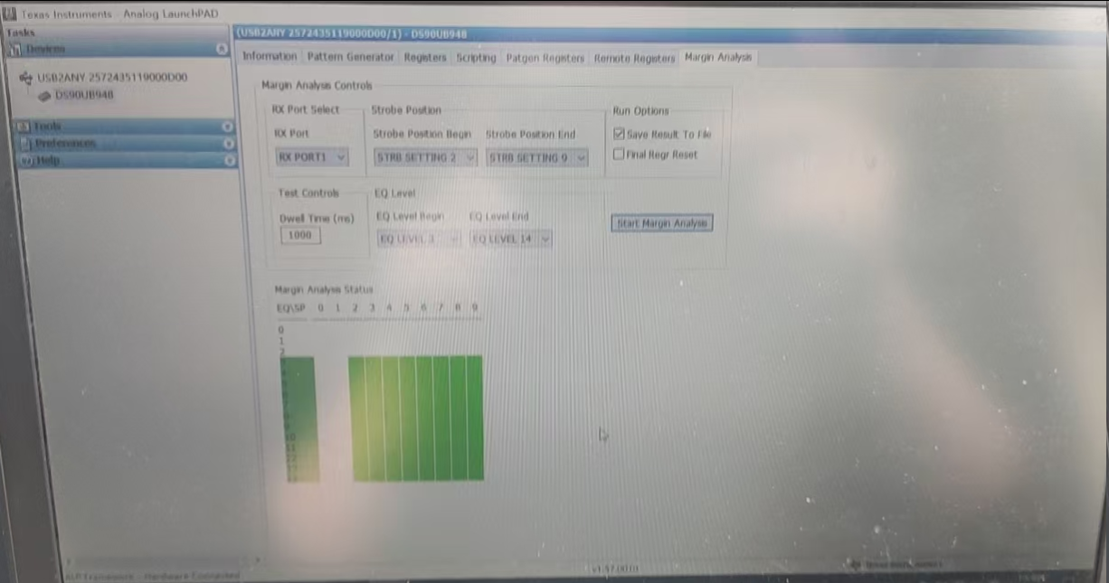

Hi FAE,
According to the suggestions of ESther Chang, I carried out the map analysis under the normal operation of the real vehicle. The RX0 and RX1 measurement results are all green. There is no FDP3_LINK_RDY=0 in the actual vehicle tracking, and the map analysis was not carried out when the fault occurred. The fault should be an occasional problem. I want to know what factors are related to FDP3_LINK_RDY=0, and then we can carry out targeted design checks. I use ALP to detect that the pixel clock of the ub947 has a slight jitter. Is FDP3_LINK-RDY consistent with it is LVDS clock signal related?
  • Hi Zhan,
    Thank you for providing the previous E2E and the MAP tool results.
    Can you confirm that this MAP program was run on a vehicle that showed the failure at occasional times? May not be run at the same time as failure but we want to ensure it is the same setup.
    The FPD3_LNK-RDY signal does depend on the incoming LVDS clock signal. The FPD3_LNK-RDY bit is determined by FPD3 PLL and OLDI PLL locking to the correct frequency and detecting a valid device downstream via BC I2C communication.
    If we set 0x5B[5]=1 RST_PLL_FREQ, the FPD3_LINK_RDY flag should only depend on the FPD3 PLL lock and downstream deserializer detection (no OLDI PLL dependency)
    From the prior E2E, can you share a register dump of the 947 and 948 at the time of failure?
    We are looking for BC_CRC errors on the 947 and FC_CRC errors on 948. This will give us direction on whether this is a signal integrity issue on the FPD3 datapath.
